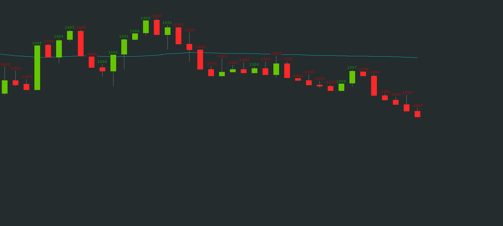

I'm trying to get the exact amount in delta for each bar. Let's say I have the setting at 2500 delta, a lot of candles will exceed the 2500 threshold. If I switch to volume per bar it's the same but can be eliminated with the option to split data records.
How to get accurate volume delta bars?

Hey SC Engineers,
this is still not addressed. A 1000 Delta Bar chart shows very often more than what is specified in the chart settings. Charts look therefore very different compared to other platforms like e.g. IRT. Could you please fix this in some of the next releases?

This inherently is not possible to resolve and we are not going to spend any further time on it at all. There is inherently no solution. You should realize that.

I think its impossible because you would have to split up single trades in order to match your delta setting.
Thats what i think...
