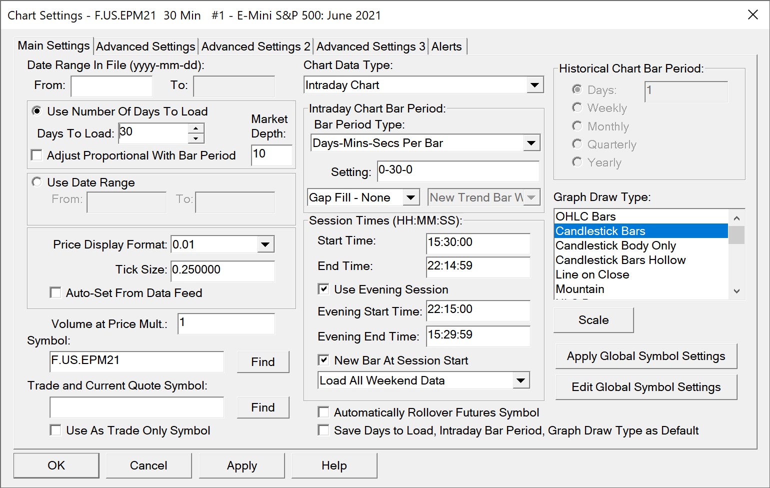

I get blank chart when I do Find Symbol.
The same symbol is running correctly in another chart.
The only difference is the Data range box is empty.
I've also read the FAQ but not resolved the problem.
Thank you
Ivan

F.US.EPM21 30 Min #1 | Reloading chart. | 2020-05-27 18:23:51.625
F.US.EPM21 30 Min #1 | Currently no data in file to display. Will start historical data download and real-time updates. File: C:\SierraChart\Data\F.US.EPM21.scid | 2020-05-27 18:23:51.651

HD Request # 1 | Error downloading historical Intraday data for F.US.EPM21. Historical data file not available for symbol. | 2020-05-27 18:23:58.735
Historical data download thread signaled to stop. | 2020-05-27 18:23:58.735
HD Request # 1 | Received 0 records from 00:00:00.000 to 00:00:00.000 (0.0 seconds) and wrote 0 records for F.US.EPM21 | 2020-05-27 18:23:58.735

This is not the current futures contract:
F.US.EPM21
You are trying to open the symbol for the June 2021 contract, not the June 2020 contract.
[2020-05-27 18:15:05]
wiivanil - Posts: 14
I'm sorry. Thank you
