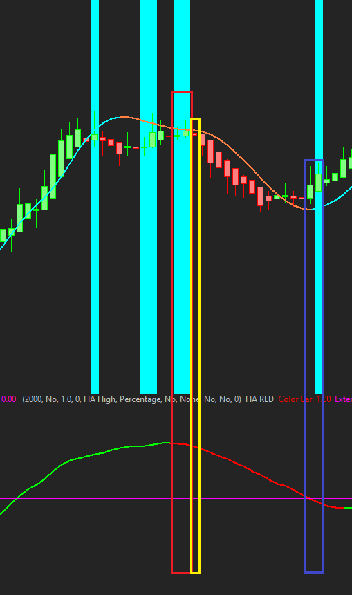

Thank you for the reply Ackin, I've used those that you suggested but they only signify changes in slope, not the actual continuing state of slope (either positive or negative). I tried your slope signal alert (based on study) which signifies changes from +/- like those suggested and it does a superb job, but only for one bar. I need it to repeat that alert until it changes states again. Any ideas of how that could be accomplished? Also, in your slope signal alert study, the alerts are always a bar behind the change in slope, but if I use the formula examples in SC, they alert on the bar OF the change. Any suggestions would be greatly appreciated.
In the first example, I dont want it to initiate trades on bars outlined in red where I have a 2/3 long signal but cant confirm because there is no alert present for the slope so it wants to initate a long trade there, but the next bar outlined in yellow, it should initiate a short on that bar. And again in the bars outlined in blue, it's trying again initiate a long position and it should not be because I have a neg slope, but no ability to alert that.

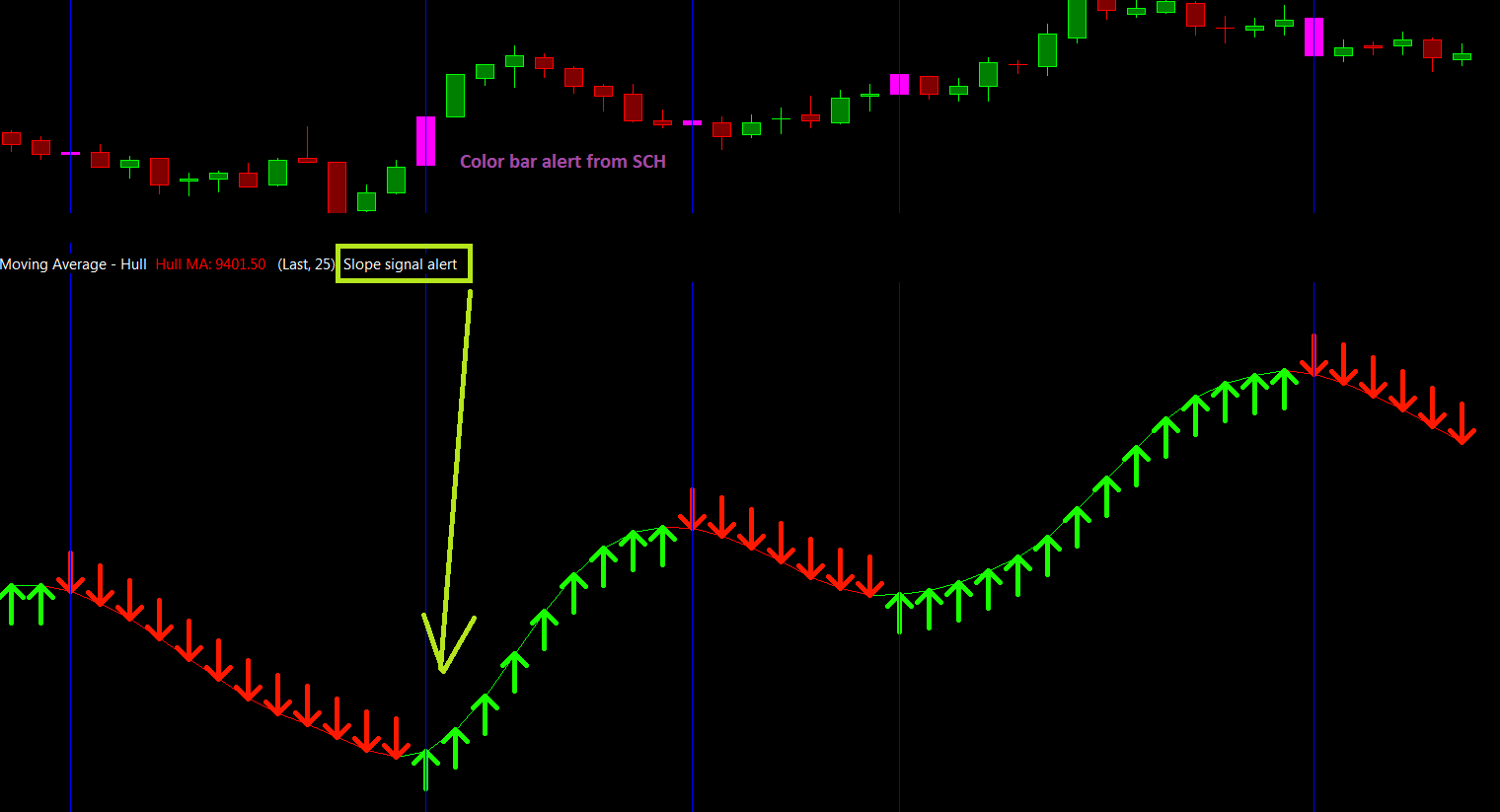

In the second example pic, its just showing the alerts being 1 bar behind on the slope change.

yes, I have it on purpose, the slope is constantly changing on the creating bar. Many of the studies I have create are for automatic systems. With the micro resolution of the graph it is negligible, but I understand that it can be a problem on large bars .... I will add this modification there (as a user selection)

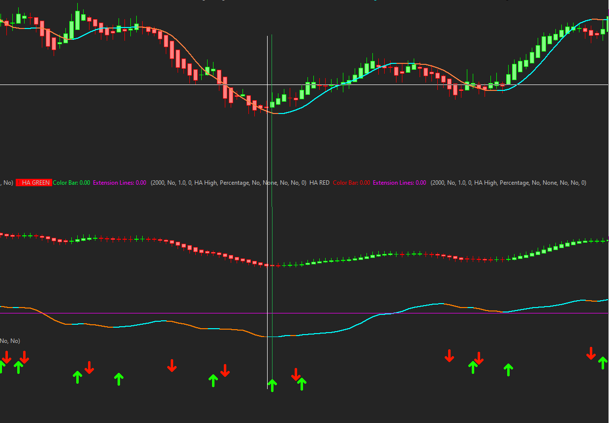

Colorbar SCH (alert what I wrote above) and Slope signal alert study
