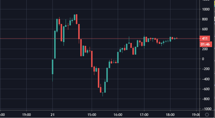

NISS got to a low of +1000 in an S&P market that was down 40 points. this would require a few stocks to be drastically down vs the whole market.
Other vendors were down into the -700 range.
UDVR never got below 1:1 with a market down 40 points
NVOL has been positive all day. with a market down 40 points...
I know each vendor calculates things slightly different and I understand that. but we are way off today. having a Advance Decline reading of +1000 with a market 40 points below previous close is red flag.....
Again thanks for your time and interest in this matter.
I have added a photo from a different vendor to give insight as to the difference today. Not sure how closing price can be so different between vendors???
Doug
Date Time Of Last Edit: 2020-05-21 18:20:20
imageADD_From_Different_Vendor.png / V - Attached On 2020-05-21 18:19:05 UTC - Size: 13.34 KB - 533 views

Profile Trader - Posts: 182
UPDATE:
Todays data seems to be on par with other vendors today. No major differences.
