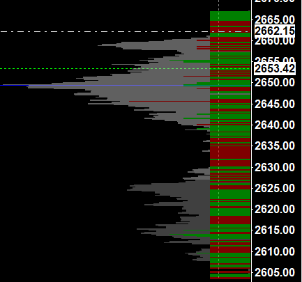

Hi there, is there any way to do this currently (I have attached a screenshot showing what I mean)?
If not, can you please add this mode in a next update?

[2020-05-20 17:40:05]
Alberto Gauer - Posts: 121
@Sierra Chart Engineering
Hi, thanks for replying.
I already tried that, it is not the same thing as what I suggested.
The Bid and Ask Volume Coloring Method will color the full histogram, so you don“t have a visual reference of how much of that volume is buying or selling. In the picture I posted here, the volume profile will have the delta profile mode inside the total volume profile.
In essence, what I suggested is having both total volume and delta volume overlaid in the Volume Bar Calculation Method.
[2020-05-20 19:04:42]
binaryduke - Posts: 387
The issue with post #3 is the scale. Often it's not possible to see the delta as it's such a small proportion of the total volume. The ability to run the delta visualisation as a separate scale to the volume is what would make this really useful.
[2020-05-24 20:49:46]
The request to allow scaling of the Delta volumes has been on our To-Do list. We just can't give any time frame for when we will be able to get to it.
[2020-07-14 19:42:31]
We have added the functionality to allow for scaling of the Difference of Bid and Ask Volume Coloring when using a Volume Calculation Method of Total Volume, Bid Volume, or Ask Volume.
Refer to the documentation for the 2 Inputs that control this starting here:
Volume By Price Study: Draw Difference of Bid and Ask Volume Using Percent of Max Bar
This change will be in the next Pre-Release (v 2137).
[2024-10-15 11:03:58]
User141735 - Posts: 14
can you please find out why the Difference of Bid and Ask Volume is displayed like this ?
https://ibb.co/mRSsX9d
it is hiding a big part of the Total volume low nodes.
