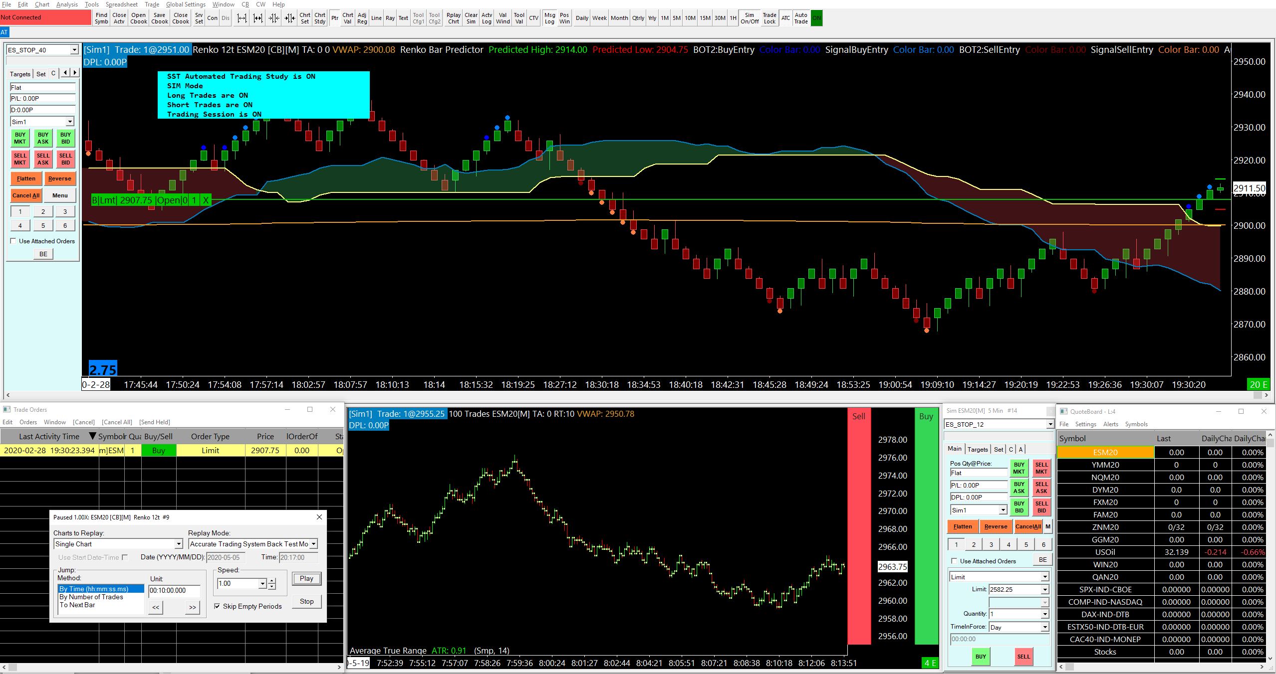

I am ruinning an automated ES trading system based on Spreadsheet System for trading. Not sure if I am doing something wrong but what I realised is that the system fills trades at levels which have not been actually reached in the backtest. The attached picture will clarify what I mean but basically the system buys at a price after the buy signal fired which has never been reached.
I am not sure if there is something wron with my settings or if other users experience similar issues.
Thanks for your help

image2.JPG / V - Attached On 2020-05-19 10:39:47 UTC - Size: 870.17 KB - 514 views

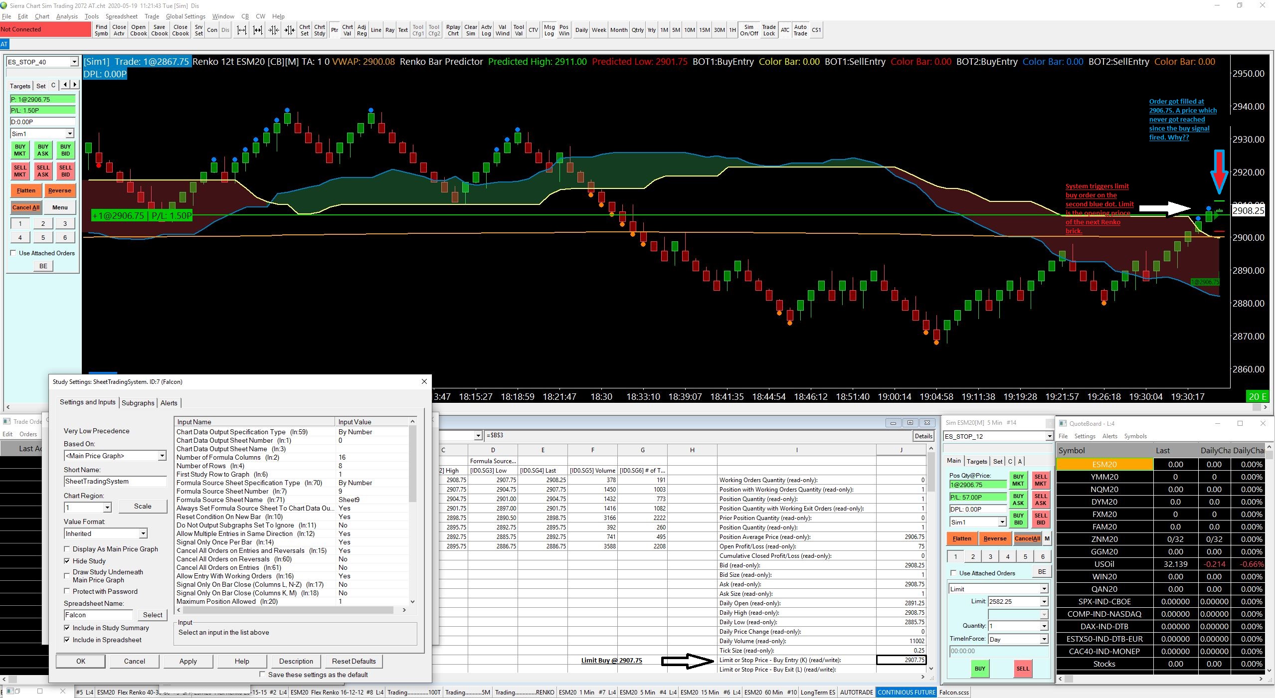

Data cannot be the issue. I am using the Denali data feed. I did some futher testing and realised that the problem does not exist if I am using the Automated Trading System form a Third Party developer.
This is by no means advertisement but I would like to make the developers aware of the problem. The third party system is I use for comparison is SST AutoTrader Study from simplesystemtrading.
As you see in the picture attached, the order has not been executed as the ask price never dropped below the limit.
How can the different outcome been explained?
image3.JPG / V - Attached On 2020-05-19 11:33:08 UTC - Size: 482.76 KB - 436 views

We are deleting incorrect posts here. Someone linked to another thread and then you went into that thread and posted in there about the issue. We deleted that. Users are using different data feeds, and the source of problems is different for this and other reasons.
We need the fill record line from the Trade Activity Log because it contains the price information explained here:
Trade Simulation: How Orders are Filled
Provide us that line. Instructions:
Trade Activity Log: Providing Trade Activity Log Data Lines to Support
Also refer to this section here to understand Renko bar values:
Renko Bar Charts: Renko Open, High, Low, Close Values
The problem may be related to that.

Please find the trade activity line below and attached:
ActivityType  DateTime  Symbol  OrderActionSource  InternalOrderID  ServiceOrderID  OrderType  Quantity  BuySell  FillPrice  Price  Price2  OrderStatus  FilledQuantity  TradeAccount  OpenClose  ParentInternalOrderID  PositionQuantity  FillExecutionServiceID  HighDuringPosition  LowDuringPosition  Note  AccountBalance  ExchangeOrderID  ClientOrderID
Fill  2020-02-28 19:30:23.388  [Sim]ESM20  Trade simulation fill. Bid: 2906.50 Ask: 2906.75 Last: 2908.00  531760  531760  Limit  1  Buy  2906.75  2907.75    Filled  1  Sim1  Open    1  531760.1
attachmentLog.txt - Attached On 2020-05-19 11:55:10 UTC - Size: 513 B - 419 views

Well what we are going to do is validate whether the pricing you have was actually what was transmitted by the exchange, and if so we then need to add an option not to use the bid and ask prices because they are not always as expected.
[2020-05-19 19:21:14]
rainbow47 - Posts: 68
Thank you. I doubt that the S&P future jumped 1 point without any trade in between. Never saw this happening before.
Problem is, that the issue makes all backtests obsolete because the executiom is unrealistic and too optimistic. Not sure if this only happens with Renko charts. But when you backtest over a longer timeframe with more than 1000 trades, the numbers are completely off and inflated to the upside.
I backttest for 90 days and the problem occurs many times over the course of the period.
Date Time Of Last Edit: 2020-05-19 19:48:12

These prices are confirmed to be valid and what were transmitted by the CME at the time:
This is with certainty that those were the latest bid and ask prices provided, at the time of the trade.

In regards to post 11 and post 12, it depends upon what the data is. That is not something that we have control over. The best we can do is add an option to not use the true bid and ask prices during a replay which we will do at this point in time.
Date Time Of Last Edit: 2020-06-03 02:02:13
