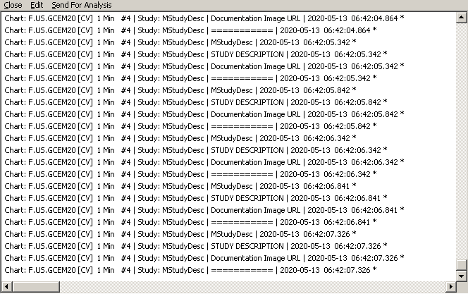

[2020-05-13 10:43:32]
User562525 - Posts: 35
Check uploaded file of it printing just fine in build 1983
imagescreen02.png / V - Attached On 2020-05-13 10:42:40 UTC - Size: 21.27 KB - 317 views
