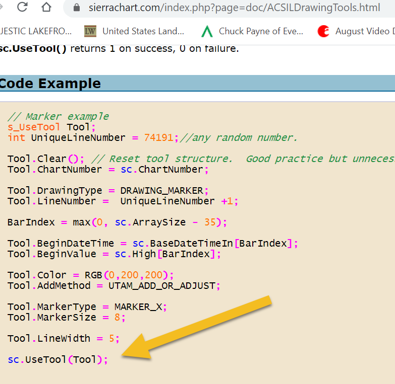

JohnR - User831573 - Posts: 340
It looks like you forgot to call usetool at the end to 'set' the things you changed in the structure
See in the attached in the docs example
imageSample.png / V - Attached On 2020-05-06 11:43:15 UTC - Size: 83 KB - 509 views
[2020-05-06 12:06:14]
User462086 - Posts: 203
Can't believe I forgot that. There was a 'programming help' element to the question after all.
"drawing.UseToolConfigNum" returns the correct configuration number but the drawings still aren't being updated. Luckily a similar approach will update the drawings' color.
Thank you JohnR.
