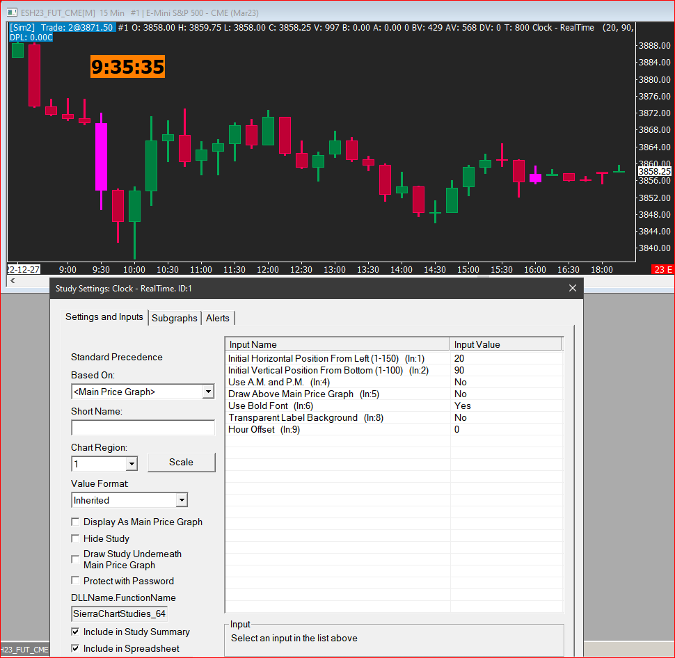

do you mind sharing images of your inputs and settings. I have it all set up and not sure why its not alerting sound.
[2022-12-30 14:40:07]
Sawtooth - Posts: 4361
You can also put that formula in the Color Bar Based On Alert Condition study, and it will color the Opening and Closing bars.
The chart bars need to be time-based.
Date Time Of Last Edit: 2022-12-30 14:42:53
imageOpening Closing bell.PNG / V - Attached On 2022-12-30 14:39:57 UTC - Size: 58.4 KB - 326 views
