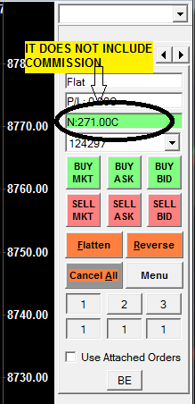

What I have to do to add commission in the NPL trade window?
I tried following steps:
Symbol settings > Use Global Round Turn Commission > Selected the instrument (MNQ in this example)> Round Turn Commission
I have attached the image
Date Time Of Last Edit: 2020-05-03 13:03:30
imageTrade Window.png / V - Attached On 2020-05-03 13:02:49 UTC - Size: 15.2 KB - 425 views
[2020-05-04 10:16:03]
You need to enable this setting:
Chart Settings: Use Symbol Commission Setting in Trade List and Statistics Calculations (Chart >> Chart Settings >> Trading menu)
