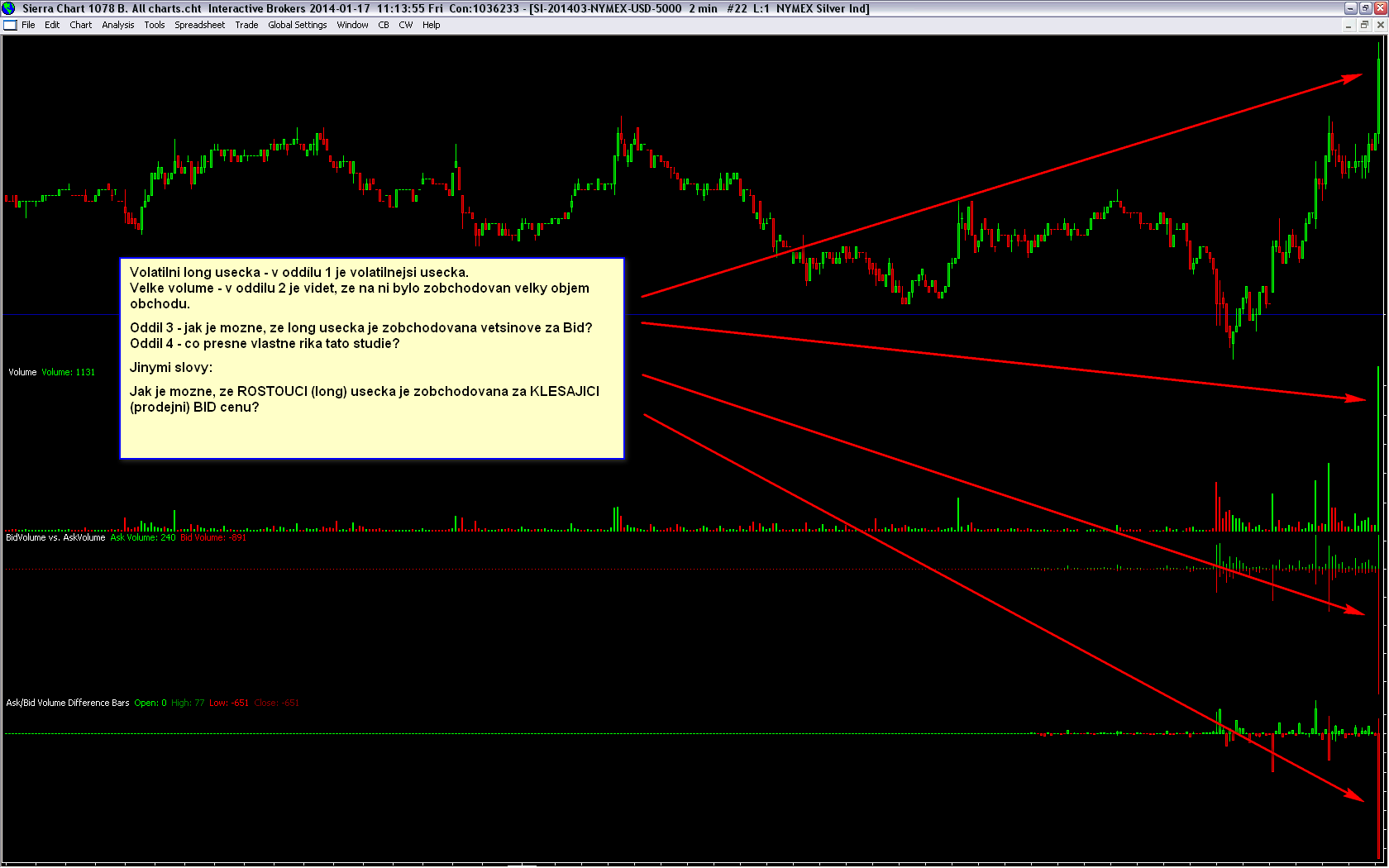

hi, i would like to ask you about my question which is on the screen. i will translate my message here.
volitility long bar - there is volatility long bar in section 1
huge volume - in section 2 we can see there is huge volume on this long bar
section 3 - how is possible the LONG bar has been traded for Bid price
section 4 - what exactly does this study mean?
in other words:
how can be possible the GROWING (long) bar has ben traded for DECREASING (selling) bid price?
thanks to everyone

[2014-01-17 17:42:43]
This problem has to do with how the Interactive Brokers data feed works.
For accurate data and charting, we recommend using the Sierra Chart Futures data feed:
https://www.sierrachart.com/index.php?l=doc/SierraChartRealTimeFuturesStockDataFeed.php
What you can do for now is right-click before the bar with the large volume and select Delete Data and Download.
Date Time Of Last Edit: 2014-01-17 17:43:19

[2014-01-20 00:42:34]
Interactive Brokers True Real Time Data does not provide accurate bid volume and ask volume which are necessary for some of the studies being used.

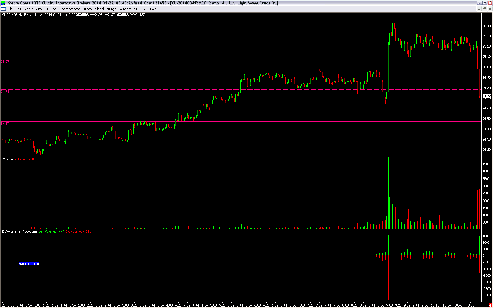

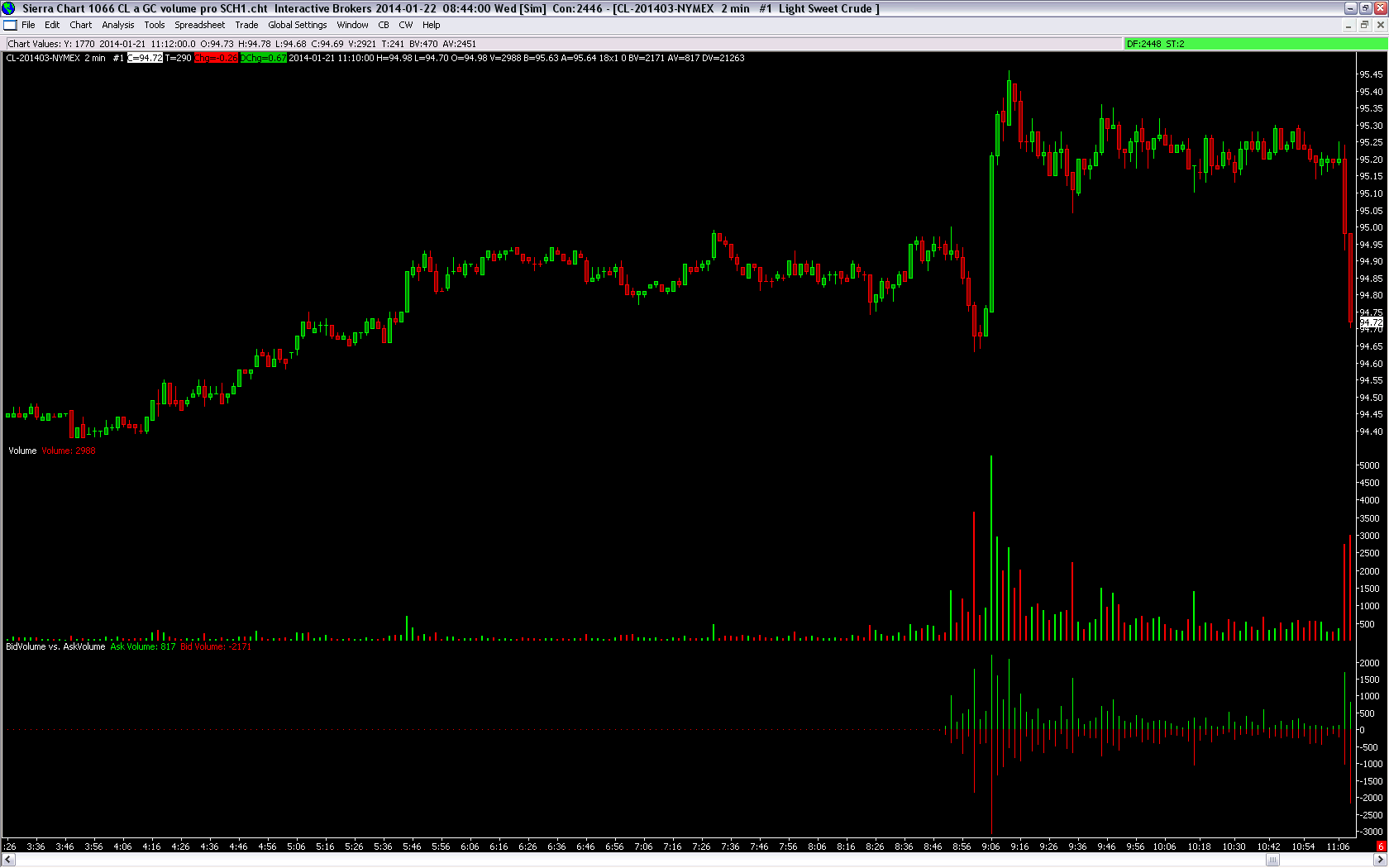

mayerrs - Posts: 70
are you sure? i made this test.
1st pic: i use RECORD TRUE REAL-TIMEDATA IN INTRADAY CHARTS
volume: 2738
bid vol: 1447
ask vol: -1291
2nd pic:: i DID not use RECORD TRUE REAL-TIMEDATA IN INTRADAY CHARTS
volume: 2988
bid vol: 817
ask vol: -2171

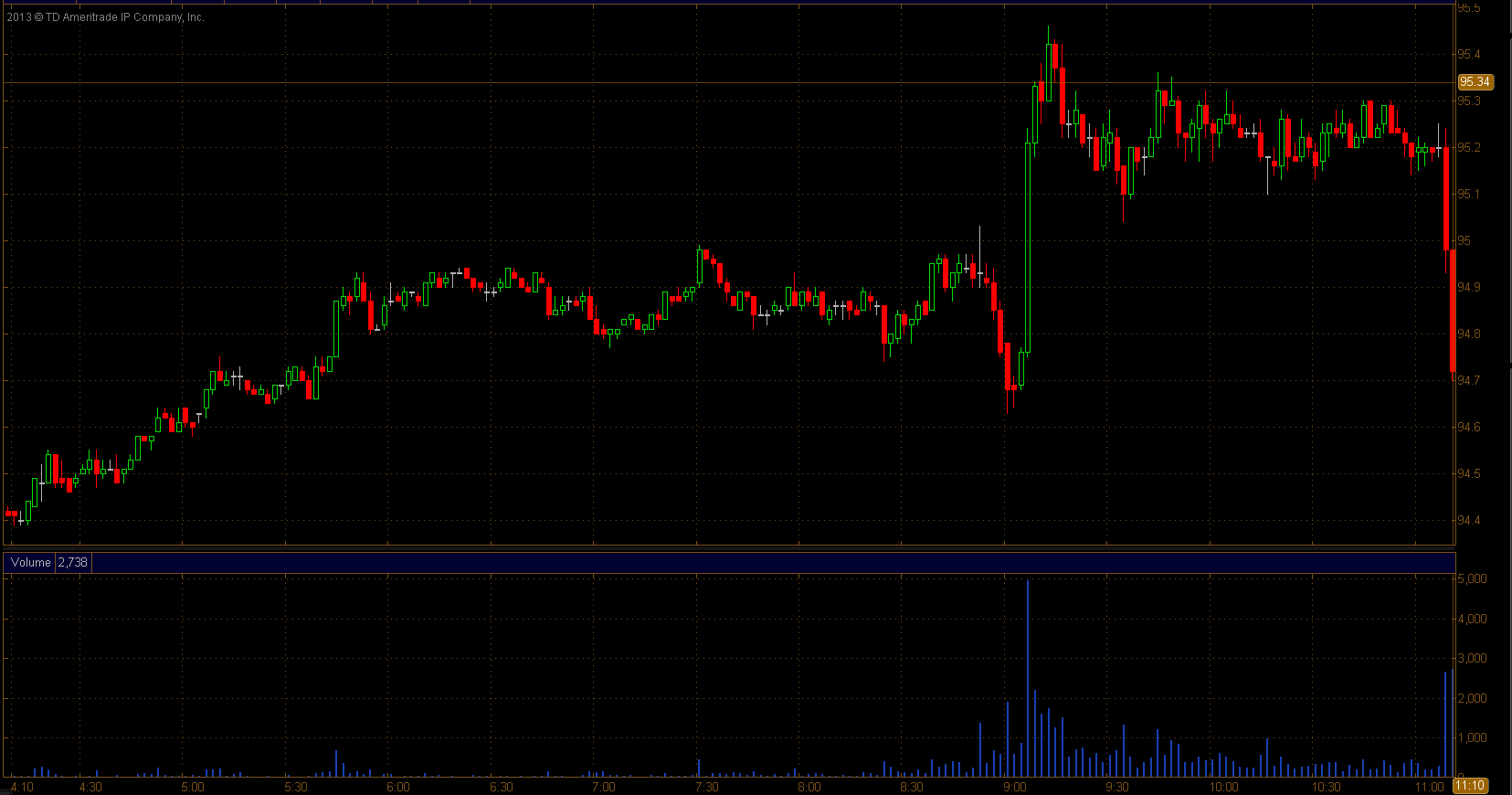

3th pic: thinkorswim
volume: 2738
so, that is my reason to believe the data in "ECORD TRUE REAL-TIMEDATA IN INTRADAY CHARTS" are accurate, arent they. a have not been able to get bid/ask vol in thinkorswim but when i can see the volume are the same in bouth, it means the data are accurate. so, what do you say? where is the true?

[2014-01-22 17:19:56]
Bid Volume and Ask Volume are not accurate with Interactive Brokers True Real Time data. This we are 100% certain of. The volume over a period of time may be accurate. But not Bid Volume and Ask Volume. This is clearly documented here:
http://www.sierrachart.com/index.php?l=doc/IB.php#TrueRealTimeData
For accurate market data use the Sierra Chart Real-time And Historical Futures Data feed:
http://www.sierrachart.com/index.php?l=doc/SierraChartRealTimeFuturesStockDataFeed.php
[2014-01-22 21:14:36]
moonmist - Posts: 127
Monkey Bars the study will allow you to also use candles/ bars etc
The study vs the chart type has more options
Also, if you are wanting to use Volume Profile - do not trust it. TOS does not have true tick data, they receive it in blocks
The nodes are not even close to being accurate at any setting
https://www.bigmiketrading.com/thinkorswim/26078-volume-market-profile.html
