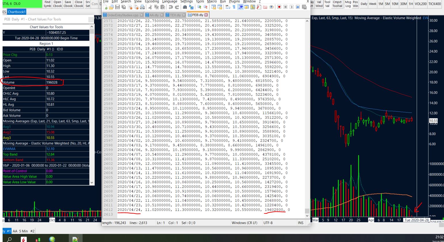

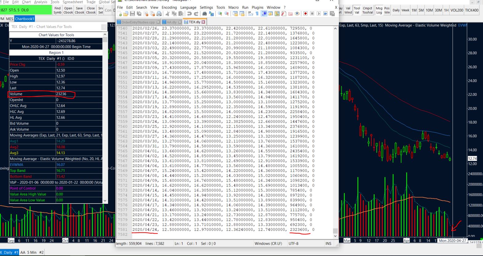

I have an issue with volume data from Interactive Broker.
First, volume values in SC are not the same than TWS platform, do you know why is that? They differ but the relation between them are ok.
Second and most important, when I insert the Volume study in a chart, the last bar volume is not presented correctly. (Chart is historical daily)
I think this is a problem with the study and not the IB data, bacause if I go to Edit-Edit Data-Historical Chart, the volume data for the last bar is ok, but in the graph study is presented with two less zeroes.
I am attaching a couple of screenshots to illustrate the issue.
Could you give it a check?
imagevolume data issue SC.JPG / V - Attached On 2020-04-28 03:26:50 UTC - Size: 302.48 KB - 478 views
imagevolume data issue SC 2.JPG / V - Attached On 2020-04-28 03:26:59 UTC - Size: 289.68 KB - 421 views

[2020-04-28 23:11:59]
User841513 - Posts: 15
Hi. Thanks for your reply.
Why is it that you can not provide further help about this? I think this is a problem on the Sierra Charts side because the data is correctly downloaded as you can see on the image I attached.
The problem resides on the presentation of the data on the chart where the last bar is missing two zeroes on the volume info.
On the link you sent is stated this:
Update: There was a problem with the historical volume data not getting multiplied by the specified multiplier in the TWS contract data in a version after 2033 but this has been resolved in version 2062 and higher. Make sure you are running version 2062 or higher.
I am using version 2092 but this problem is still present on the historical volume data on the equities charts. It is not getting multiplied correctly.

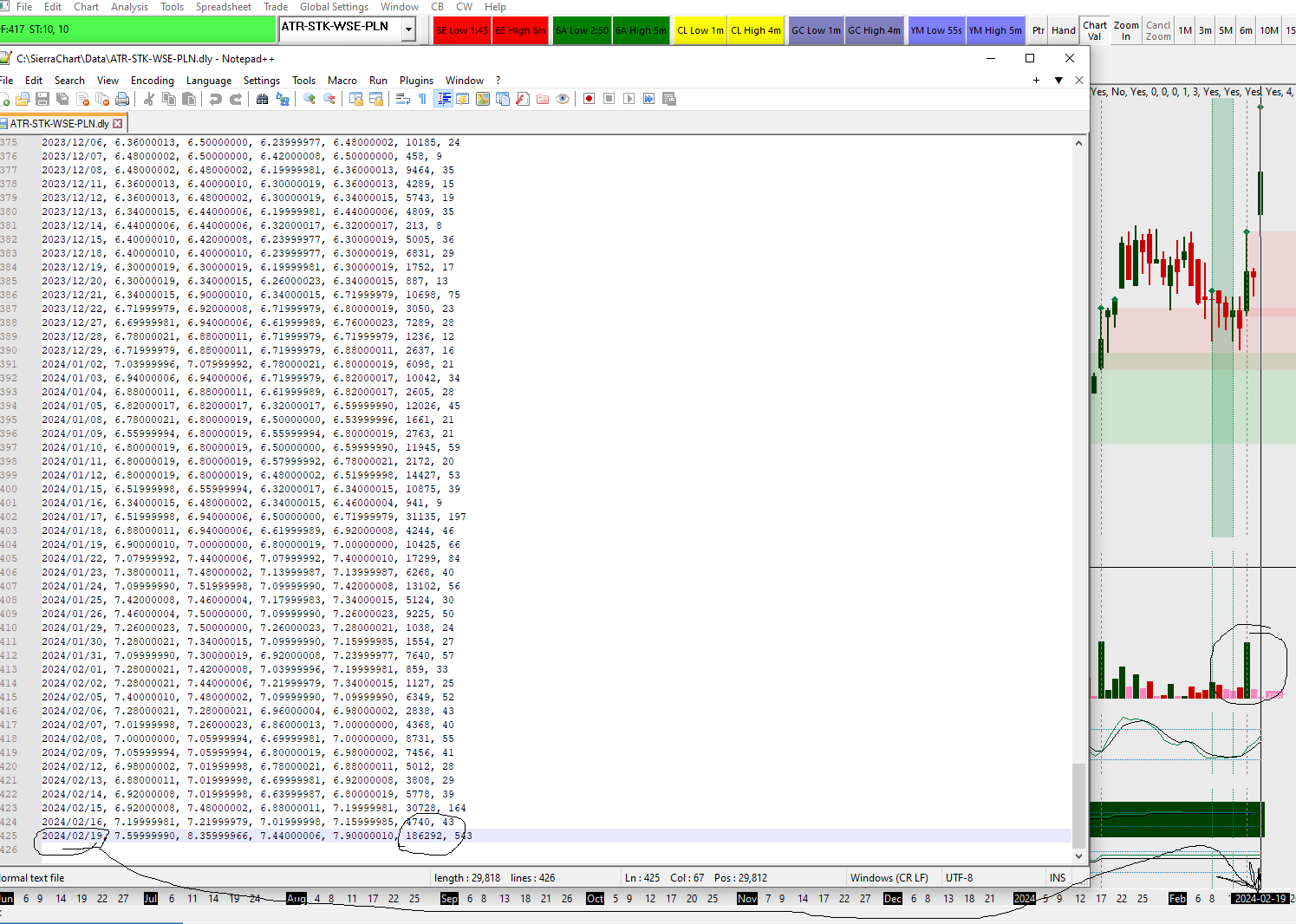

Hey guys, has this case been resolved after these 4 years? I have similar problem using SierraChart with data from Interactive Brokers. The attached symbol is from Warsaw Stock Exchange and the last bar has highest volume. In the *.dly the volume is correct, but Sierra for some reason displays it correctly for split second, but after like 3 seconds it shrinks it significantly making it unreadable...
btw. I downloaded latest version of SC - still the same
[EDIT]
After changing currently selected service to SC Data - All Services - The volume now is displayed correctly (but the ticker is of course not available via SC Data, it needs to be read from Interactive Brokers service, but after it is downloaded, the *.dly file containing all the data is physically on drive, so I'm able to open it with SC Data) so THE BUG seems to be in place in handling the Interactive Brokers service. Please have a look and provide the fix :)
Date Time Of Last Edit: 2024-02-19 22:59:12
imageaaa.png / V - Attached On 2024-02-19 22:12:06 UTC - Size: 124.65 KB - 183 views

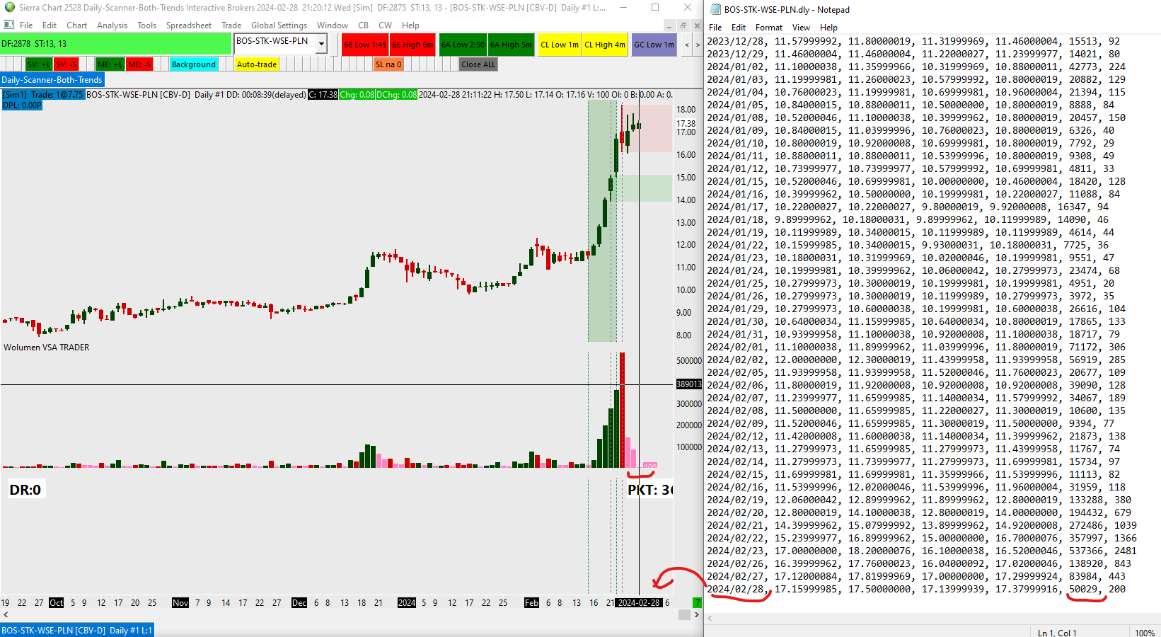

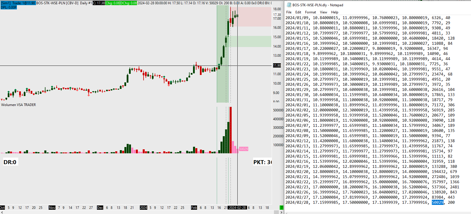

User851058 - Posts: 10
In the attached picture You can see, that the Volume for the last bar from 28-02-2024 should be 50029, but the label is showing 100 (picture 2). It seems to display the Volume bar correctly for the very first second, than the bar gets much shorter and is showing the value of 100. It only happens when I use the Interactive Brokers data service. When I switch it SC Data - All Services, it is showing correctly (picture 2) - of course I first have to switch it to Interactive Brokers to be able to download the *.dly file, so that the CSV are physically on my disk, than I can switch to SC Data just to display the downloaded *.dly
imageSCBug.png / V - Attached On 2024-02-28 20:29:10 UTC - Size: 154.68 KB - 234 views
