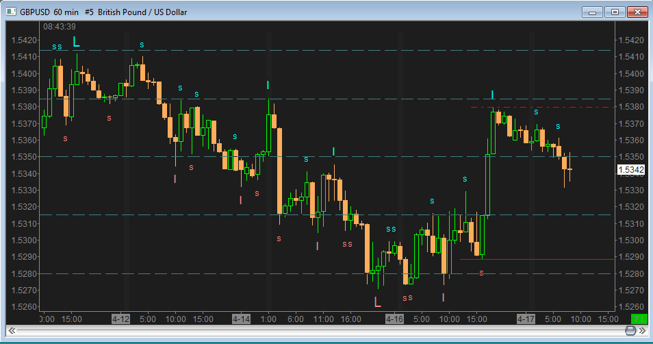

[2013-04-17 08:01:00]
Trint - Posts: 115
Would that mean I get the keys to the forum...
It needs a bit of tidying up (which I'll do today, adding comments) I'm not sure the code is the most efficient and it's not perfect but it works for what I need.
I've attached a picture of the the Study using the Hourly chart GBPUSD pair from the London Open this morning. The most recent 'I' would eventually update to a 'L' if a a lower 'I' is formed subsequently but basically a Short Term High is using the code for a Swing High. An Intermediate High having lower Short Term Highs either side of it and a Long Term High having lower Intermediate Highs either side of it. Obviously opposite for Lows.
edit: The 'Offset' study setting is needed for the chart so the MS characters are not too far away or to close to the candles.
Date Time Of Last Edit: 2013-04-17 08:03:23
imageMarketStructurePointExample.png / V - Attached On 2013-04-17 07:48:51 UTC - Size: 37.46 KB - 867 views
[2013-04-17 18:57:40]
Trint - Posts: 115
Here's that code, it'll need a review and I perhaps should've added a function to repeat the main 'logic' part for allowing both equal/non-equal highs but it works (it works off the Swing High/Low functionality that already exists). Not sure the code is the most efficient.
There is a slight discrepancy with the SwingHighAllowEqual part when identifying two equal highs or lows in succession but it's minor and I think it has something to do with the rounding in the sc.BaseGraphValueFormat?. For the EURUSD pair I like 4 decimal places and setting it to 5 sorts it out perfectly but the high or low gets labelled in any case…… Anyway have a look and see what you think.
Anyone who chooses to implement/use or run any of the following code does so at their own risk and they are responsible for any problems that may arise from using it.

        tempITLow = sc.Low[tempITLIndex];
        LTLFlag = 1;
        tempLTLIndex = tempITLIndex;
      if((sc.Low[tempITLIndex] > tempITLow) && (LTLFlag == 1))
        SwingLongLow[tempLTLIndex] = sc.Low[tempLTLIndex] - ArrowOffsetLows;
        SwingIntermediateLow[tempLTLIndex] = 0;
        LTLFlag = 0;
        tempITLow=sc.Low[tempITLIndex];
      else
    else
      tempSTLow = sc.Low[IndexToEvaluate];
Date Time Of Last Edit: 2013-04-17 19:24:40
[2013-04-23 02:25:04]
The code has been added to the User Contributed studies.
