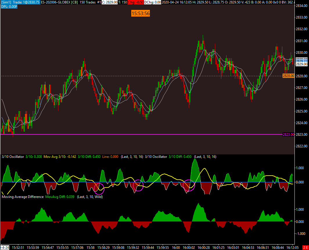

How can I color bars when the 3/10 oscillator - 3/10 Diff(SG3) crosses over the Mov Avg 3/10 (SG2). See the circled areas in the 3/10 oscillator on the attached this is where I would like the bars to be colored when the red filled area crosses above the yellow line.
thanks, bob
http://www.sierrachart.com/image.php?Image=1587930839732.png
imageCapture11.PNG / V - Attached On 2020-04-26 19:51:44 UTC - Size: 15.62 KB - 490 views
[2020-04-26 21:04:39]
Sawtooth - Posts: 4361
Add the Color Bar Based On Alert Condition study, and use this formula on its Alerts tab:
=AND(CROSSFROMBELOW(ID20.SG3,ID20.SG2),ID20.SG3<0)
where ID20 is the 3/10 Oscillator study.
