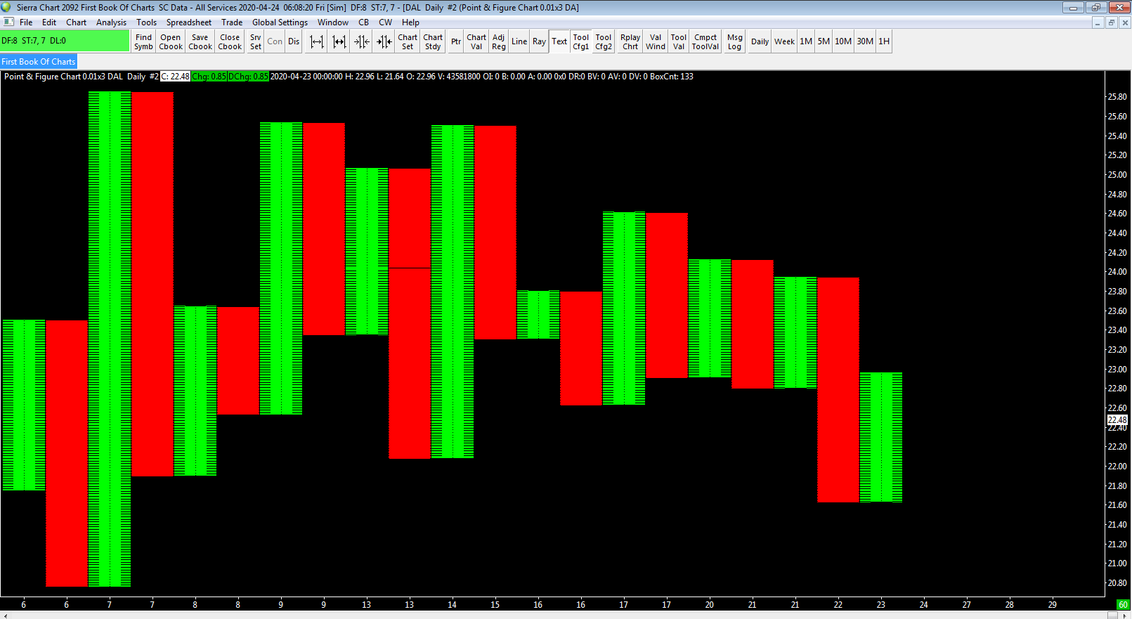

I'm reading the documentation here: Point and Figure Chart
And it looks like the Study has been replaced by going to the Intraday, but what if I want to have my point & figure use daily time frame?
I could not get it to work by going to Intraday Chart Bar Period >> Bar Period Type >> Point and Figure Bar. And I could not get it to work by going to Analysis >> Studies >> Point and Figure Chart
Can you instruct me on how to make a daily point & figure chart?

[2020-04-24 10:10:14]
lou_diamonds - Posts: 39
No, I do understand. The X's & O's don't work on the daily. No matter how far you zoom in, there are not X's & O's.
See the picture. It's not working.
imageScreenshot from 2020-04-24 06-08-21.png / V - Attached On 2020-04-24 10:09:18 UTC - Size: 58.88 KB - 379 views
[2020-04-24 10:14:13]
Ok, this is resolved. My problem was the tick size. Thanks!
[2020-04-24 18:11:23]
Or you want to increase the Box Size Study Input.
Date Time Of Last Edit: 2020-04-24 18:11:29
