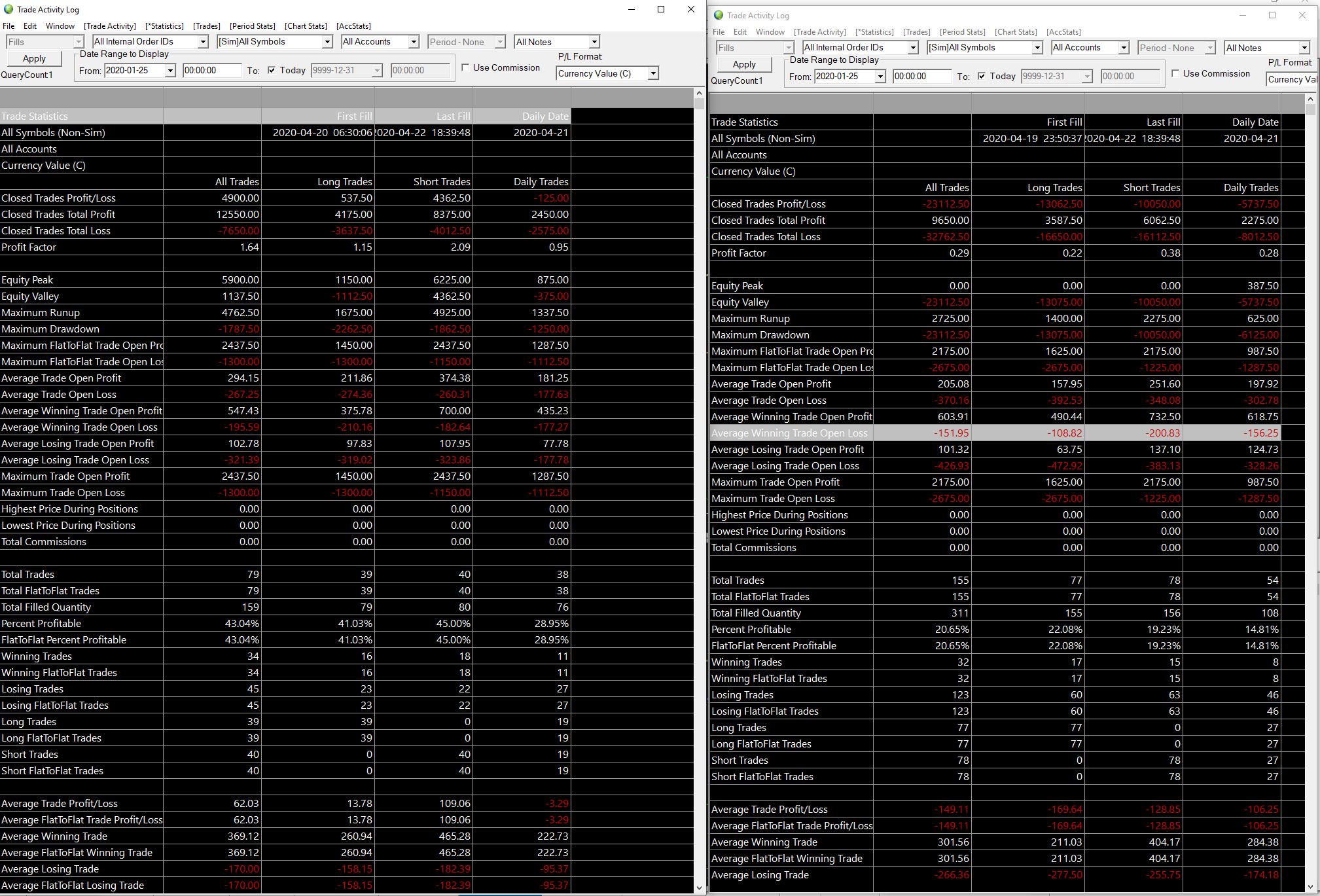

I attached the activity log stats. Both Instances I use "Accurate Trading System Back Test" and testing them with "Auto Trade System Replay Back Test". I am using exactly the same study on both.
How can the results be so different?

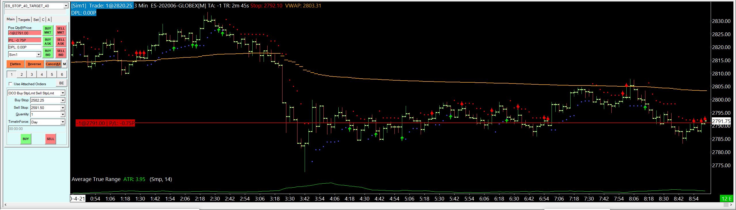

I did a bit more testing. It looks like Instance 1 is executing trades at different price than Inctance 2 when the signal gets triggered. See screenshots below.
Based on my real life tests Instance 1 is fairly accurate while Instance 2 is totally off.
Does anyone have an idea why prices for Instance 2 are off and how to fix it?
