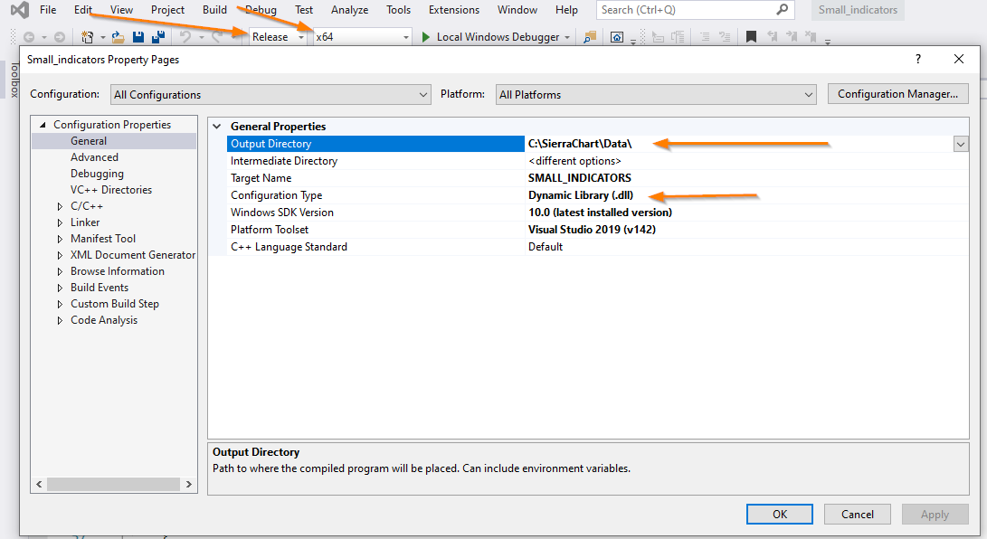

[2020-04-22 08:21:02]
Flipper - Posts: 65
This isn't a template but these are the important settings
imageSC_VS_1.png / V - Attached On 2020-04-22 08:18:33 UTC - Size: 46.23 KB - 801 views
imageSC_VS_2.png / V - Attached On 2020-04-22 08:20:05 UTC - Size: 49.12 KB - 632 views

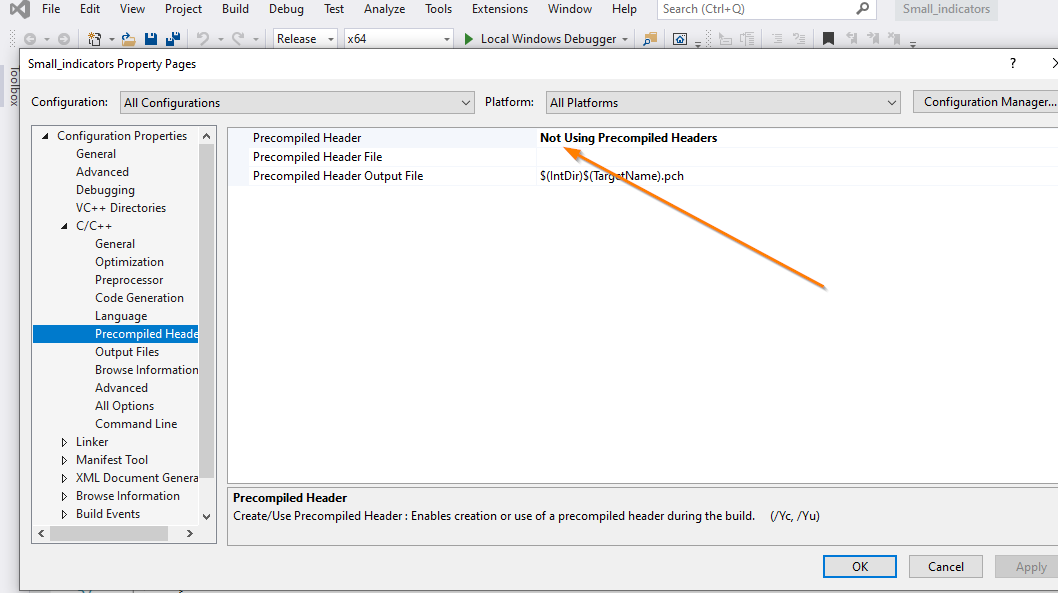

[2020-04-22 08:22:55]
Flipper - Posts: 65
Oh and change/delete Precompiled Headers
imageSC_VS_3.png / V - Attached On 2020-04-22 08:22:35 UTC - Size: 44.74 KB - 604 views
[2020-04-22 12:58:34]
JohnR - User831573 - Posts: 340
Flipper,
Many, many thanks. Woohoo ! ! !. I had the option with the Precompiled Header - wrong. I miss stuff like this at times. I have many years in past of coding, but more recently, I am self taught C# used in Ninja, and now C++ for here on Sierra. Now and then I get my knickers in a knot, as the devil is in the details. Again, thanks for your time.

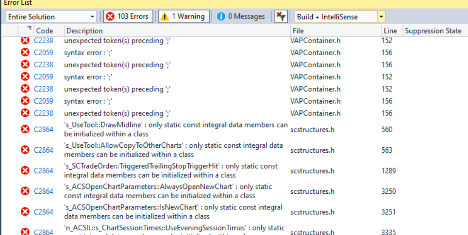

[2020-04-23 01:27:52]
User701453 - Posts: 176
So how did the two of you manage to get past all the errors in the VAPContainer.h and the scstructures.h that are returned when trying to build the solution?
Image of errors attached.
SC has not been able to provide a working solution to these errors.
I'm using SC version 2086, VS version 2017.
I also get the same errors when trying to build with VS 2010.
imageVAPContainer&scstructures.PNG / V - Attached On 2020-04-23 01:26:54 UTC - Size: 171.64 KB - 567 views
[2020-04-23 01:40:10]
Flipper - Posts: 65
Oh! could you show us some more information? Maybe the VS project properties and the basic structure of code thats causing the problem?
[2020-04-23 01:43:14]

[2020-04-23 09:37:29]
User907968 - Posts: 887
@User70143
The error is in your VS configuration or in your local copies of SC files used for VS build

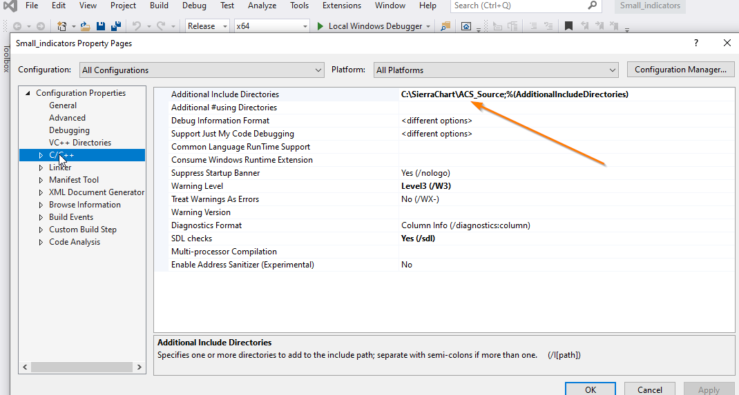

[2020-04-23 10:40:31]
Flipper - Posts: 65
Yeah it would seem there is a configuration problem on your end. Visual studio sets up and build SC .dll with no problem if I use the setting I posted post #2 & #3.
Have you also got the "VAPContainer.h" & "scstructures.h" file in C:\SierraChart\ACS_Source
and the
VS > Project > Properties > All Configurations > Configuration Properties > C/C++ > General > Additional Include Directories > C:\SierraChart\ACS_Source
[2020-04-23 16:04:29]
I have an additional "\" slash at the end. Not sure if that is it.
slash added to end
C:\SierraChart\ACS_Source\
instead of

[2020-04-26 19:47:59]
Want to report back and say thanks to everyone for the help and assistance with finally getting Visual Studio to work with Sierra
I took a VM snapshot first as I didn't want to screw up my current working setup.
I uninstalled all version of VS and rebooted.
Ran VS 2017 install and selected every option available related to c++
After rebooted,opened the project and it compiled with no issues.
Started SC and added the new VS compiled dll to the chart.
Attached to the process,set breakpoints and replayed the chart.
When breaks was hit I was finally able to modify code use the edit and continue feature of VS.

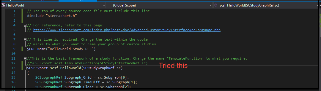

[2021-03-18 00:23:00]
silvereagle - Posts: 23
@Ticks
For the SCSFExport function I'm using scsf_HelloWorld(SCStudyGraphRef sc). Originally I had the default scsf_TemplateFunction(SCStudyInterfaceRef sc), but with your hint I dug around source and found another way that function was declared and tried that ---still no cigar though. :( After losing more hair to this problem I jumped on my native windows machine and used VS 2019 to build the dll over there using all the same steps. I just wanted process of elimination that it wasn't some obscure issue from running VS on the other machine in Parallels. So, I built that dll on the native windows machine, popped'er in Sierra, restarted...
And proceeded to lose more hair. No go for launch. It just wont show up in the Add Custom Study GUI
@User925080
Yep, that's where I'm lookin' sir and seein' a whole lotta nothin. lol.
I really-really appreciate the extra thoughts, if you have any other things I might try or check that would be awesome... as I'm really running out of ideas.
imagetriedthis.png / V - Attached On 2021-03-18 00:21:25 UTC - Size: 54.08 KB - 533 views
