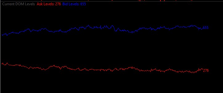

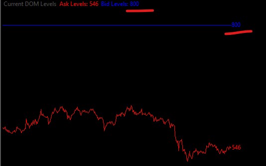

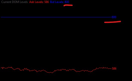

And what about increasing available depth levels to 1500 levels? Today volatile markets have depth distributed way over 800 levels (attached screens for CL and ES yesterday day session), and since market makers offset their close-to-price plays with outlying orders it affects our market mapping models to significant degree.
Denali feed is almost perfect with just that one nasty caveat. Please increase number of depth levels at least for crude and ES. The rest of assets, even those vigorous as NQ, tend to be contained within 800 levels (screen).
Really looking forward to it!!! Thank you!!!
