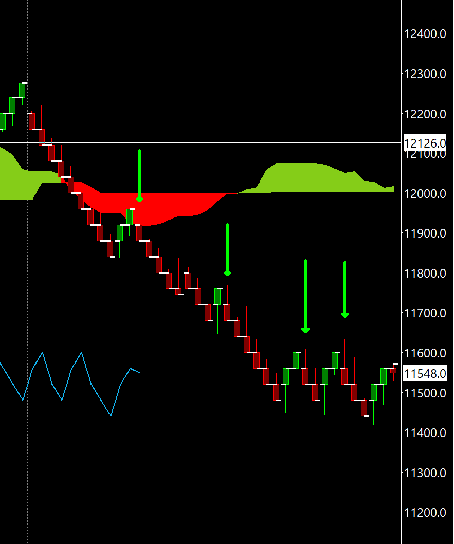

Hello, I would like to create an alert on a set of rules and I would like this alert to be made only on the first bar. If anyone can help me, it would be super nice.
The alert would be on a renko graph:
- 1st condition: change of color of the closed candle (from red to green)
- 2nd condition: the price must be above the senkou span A
- 3rd condition: The chikou span must be above the price
thank you in advance for your help
Cedric
imagealerte renko.PNG / V - Attached On 2020-04-19 13:19:35 UTC - Size: 37.06 KB - 441 views
[2020-04-19 16:00:05]
Sawtooth - Posts: 4359
Question about your 3rd condition:
The Chikou Span study has no value at the current bar, or for the previous 25 bars (because it is displaced -26 bars).
Do you want to use its [-26] value for all bars from then until the current bar, and use the plotted value for all bars [-26] and before?
(The final 2 arrows in your pic are at bars closing below the -26 Chickou Span.)

[2020-04-19 18:32:56]
and if we remove the third condition
Try this:
Green to red, close below Span A:
=AND(ID0.SG22[-1]<ID0.SG23[-1],ID0.SG22>ID0.SG23,C<ID1.SG1)
Red to green, close above Span A:
=AND(ID0.SG22[-1]>ID0.SG23[-1],ID0.SG22<ID0.SG23,C>ID1.SG1)
where:
ID0.SG22 is the Renko open
ID0.SG23 is the Renko close
ID1.SG1 is the Span A.

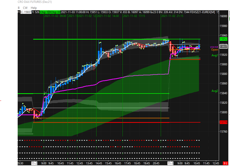

[2021-11-12 17:09:57]
User657265 - Posts: 19
Super thank you, it works, on the other hand sometimes, the alert does not appear and I do not know why.
In any case, thank you for your sharing.
I send you a screenshot of the day of November 2 with green vertical lines or the alert is not triggered
imageCapture d’écran 2021-11-12 180906.png / V - Attached On 2021-11-12 17:09:50 UTC - Size: 27.65 KB - 294 views
[2021-11-12 18:47:27]
Set the Value Format of the T3 study settings from Inherited to 0.001 or smaller.
