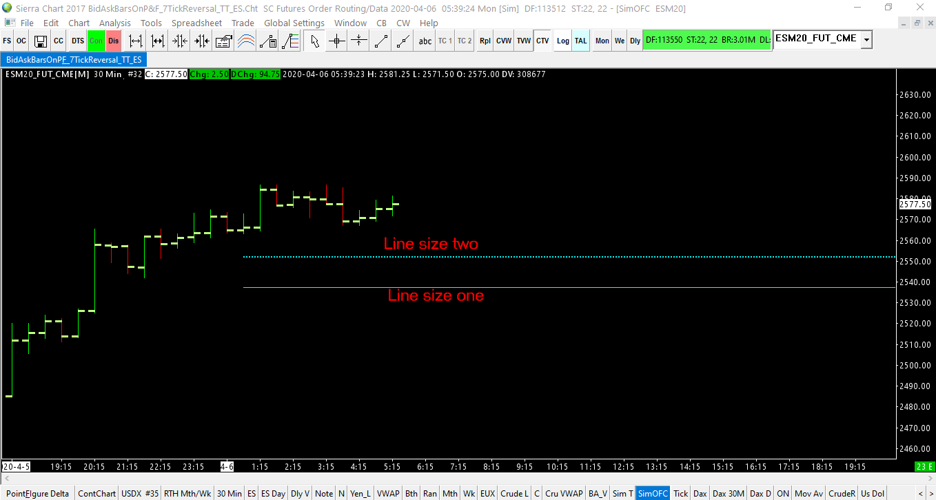

WarriorTrader - Posts: 259
The "Alternate" line style does not work in OpenGL. It is being displayed as a solid line. I am using version 2068.
FYI,
Turns out it does work but you have to set the line size to two (2). Don't know if that can be "fixed?"
Thanks,
--WT
