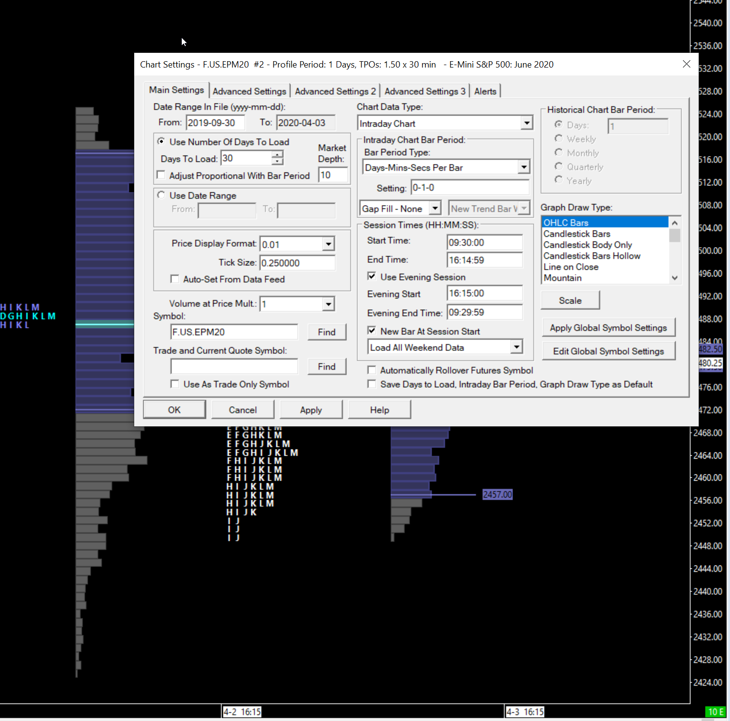

The issue I have is if I have Evening Session to be from 16:15:00 to 09:29:59. When I use the Evening Session, the start time becomes the Evening Start time. Screenshot attached showing start time for the day is at 16:15:00.
I want the start time to remain at 9:30:00 whether I look at pit session or 24 hour session. Is there another option or is 2 charts the way to go? Thanks.

John - SC Support - Posts: 48062
Just one thing to keep in mind. The exchanges consider the beginning of the trading day the beginning of the Evening Session. For example, the start of the trading day for April 3 is at the beginning of the Evening Session on April 2.
But, if you still want to see it the way you are stating, then the best thing to do is to have 2 different charts and have the Primary Session time go from 16:15:00 to 16:14:59.

User128888 - Posts: 30
thank you! I didn't realize start time is officially beginning of evening session. I went with the 2 charts options as this worked!
Just FYI, the reason I want to keep the 9:30:00 start time is because I need the actual beginning of session for the day to be the start of my Volume Profile. That would 9:30:00 for S&P. This is when most volume begins for the day and people begin trading.
