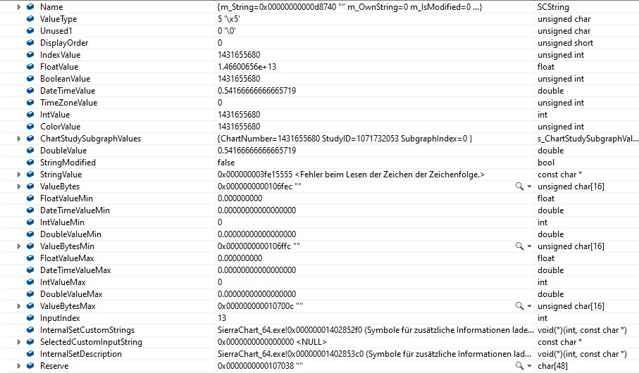

My issue is as follows: all inputs besides index 13 are initialized perfectly fine, input 13 contains weird information.

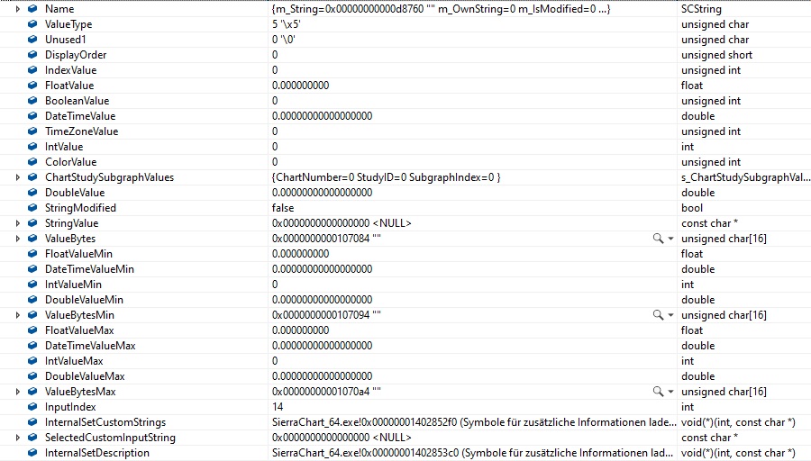

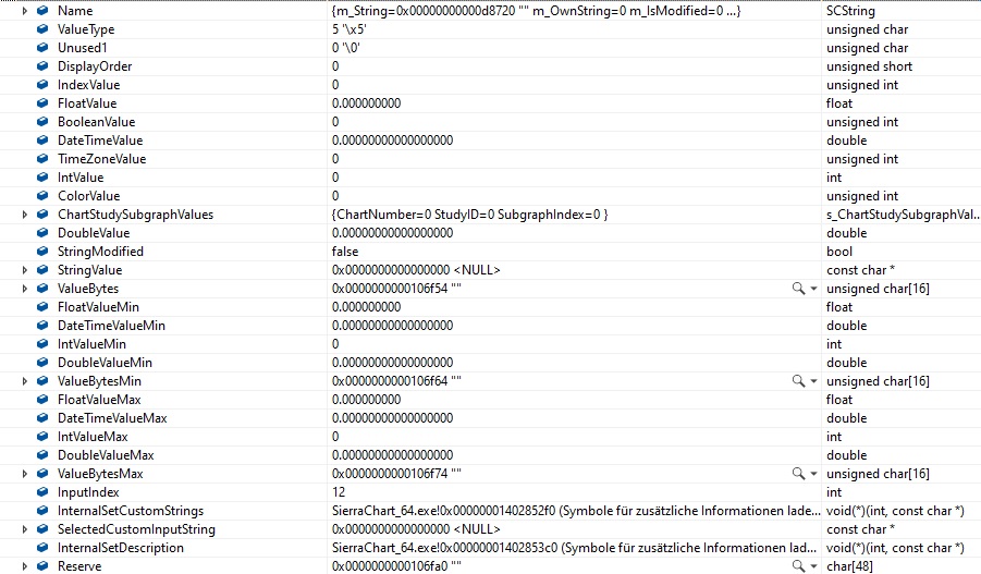

I'm aware this sounds impossible but when I debug the code and start debugging at the line where the definiton of defaults starts (Line: if (sc.SetDefaults)) - so no processing of the study has been done yet, only the definition of fields - I receive the information in the debug window documented in the attached files Input12.jpg to Input14.jpg.
Based on this information, input 12 and 14 (like all others) seem to be initialized correctly where input 13 was not.
Regardless what is being captured in input13, it does not return the information captured in the configuration window.

I resolved the issue and just like to mention the solution in case anybody else has the same issue during development:
I changed the "data type" of one of the inputs during development from storing a float at the beginning to finally storing a bool-value.
I forgot to remove the study from the chartbook and re-add it but just set the new value in the configuration dialog. This seems to cause the behaviour described before.
After removing the study and re-adding it, everything works fine.
