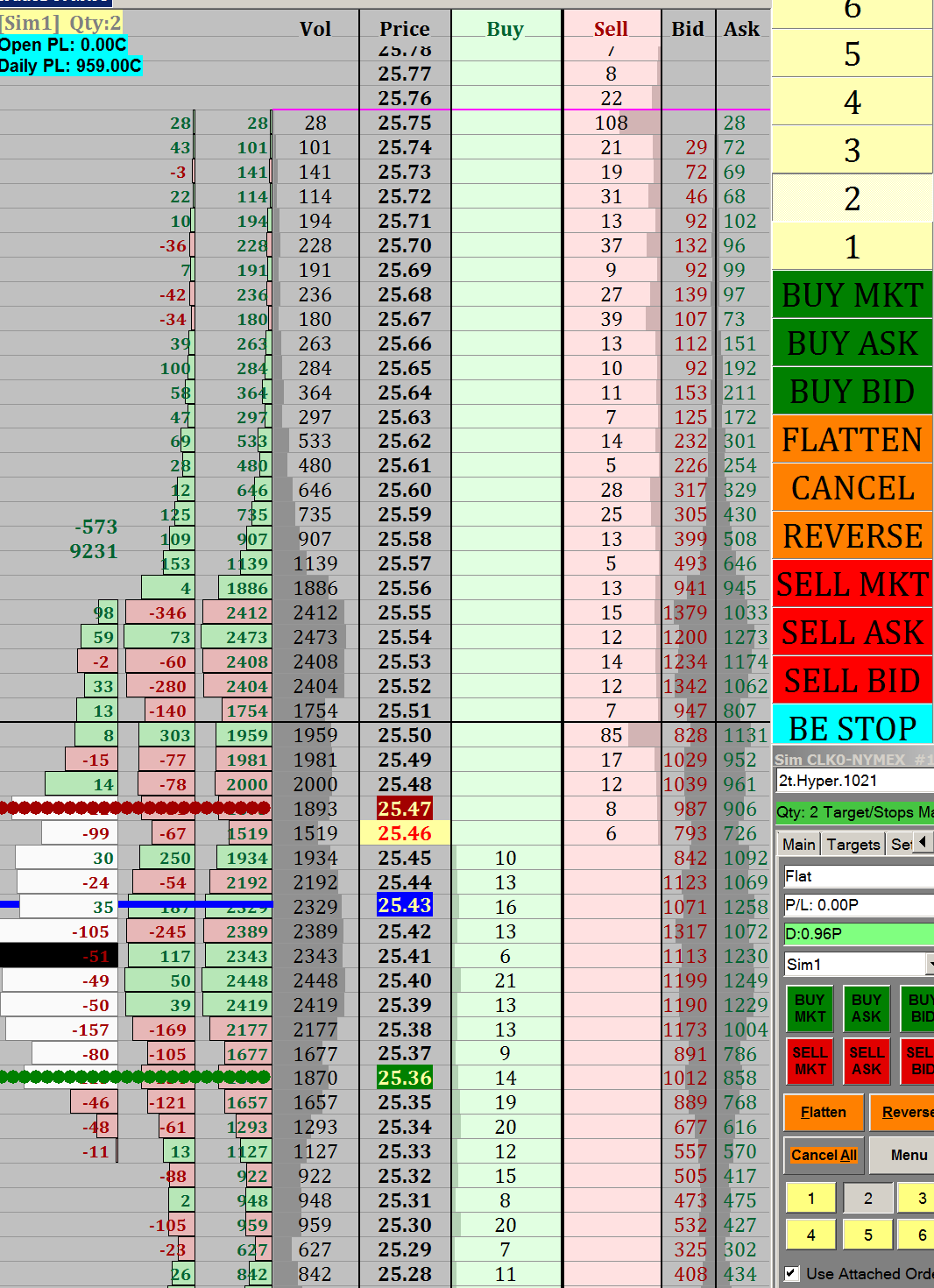

Is it possible to have 2 VBP profiles side by side with their spines aligned so one fills to the left and 1 to the right?
I currently have this setup with a VBP and CURRENT VOLUME, but it doesn't always match depending when i turn on my machine...i would like to have two daily profiles with their spines alignedback to back( 1 delta 1 total) so I can see clusters easier...also if I wish to clear the bid ask volume...it also clears current total volume.
attached 2 pics...first is current..second is what i would like only left aligned (just as current volume...so I could delete the CV column)
Thanks for help

size limit reached for attachment...so to be clear i would like to replace the current total volume column with the VBP profile that is furthest to the right...but I would like to flip it so that it is aligned to the left...every time I try and align it to the left it jumps to far left of the screen and it cant get the spines to align back to back...don't know if this is possible...please advise

If this is not possible due to the positioning of the price ladder...perhaps it would be possible to add a daily total volume (not current volume and not clearable )to customizable trade DOM columns?
No it is not possible.
We plan to be working on making the header of the Trading DOM customizable and then you will be able to include the Daily Volume.
