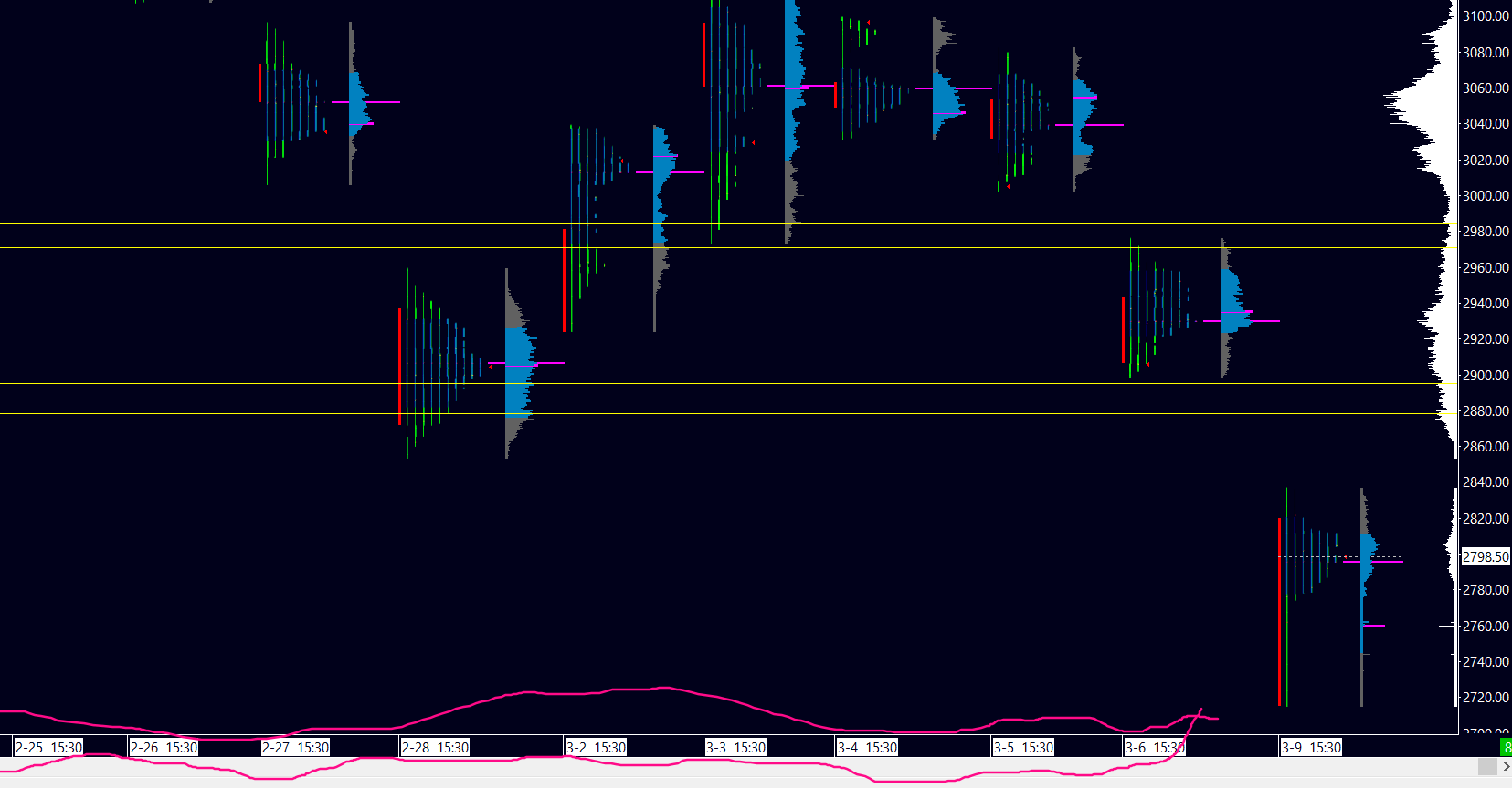

User879838 - Posts: 33
ESH20
the problem is i changed the session settings 1 hour back because clock moved 1 hour back (at my time zone it was 16:30 RTH start and now 15:30)
but all the previous profiles change also and are not correct now
there must be a way to fix it when time changes to change from current date without changing the previous profiles that started from 16:30

[2020-03-09 18:18:15]
User196369 - Posts: 41
What your attempting to do won't work.
Set your charts to be in the time zone of the exchange your trading and no more problems.
[2020-03-09 18:27:33]
The time zone of that chart must be set to a US time zone. There simply is no other possibility. And the Session Times have to correspond to the time zone. Instructions:
Time Zone Setting: Using Different Time Zone in Individual Charts
[2020-03-09 19:24:25]
Sierra Chart Engineering & User196369
thank you very much
now i understand
changed to New York time zone and all is O.K. !!!
