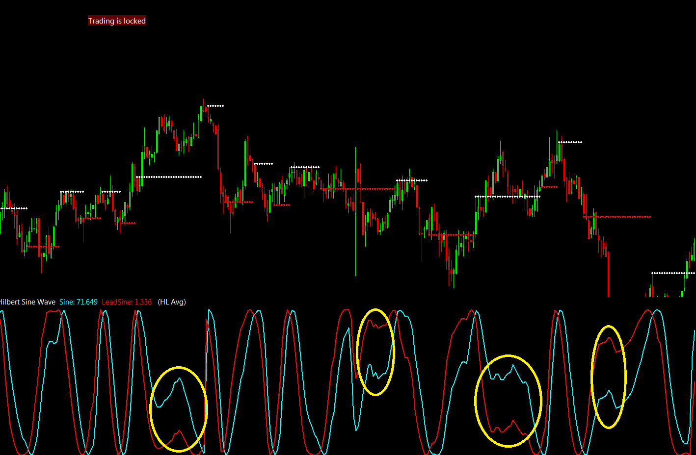

[2020-06-04 20:36:20]
User771423 - Posts: 25
Is it possible to color the line differently depending on whether the line is crossed from below or above? With spreadsheet formula.
[2020-06-05 13:46:02]
Sawtooth - Posts: 4361
On the Subgrpahs tab of Spreadsheet Formula study, set the Auto-Coloring to Based On Slope.

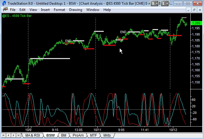

[2020-06-05 18:23:42]
Thank you, yes I tried it, but it doesnt do what I want.
I want it to alternative between two colors, support and resistance from my Hilbert SineWave crossings. Ie Sine and LeadSine-crossing.
When you have Based on slope, I understand it looks at the Spreadsheet Formula created line, not the crossing line in my Hilbert Sine Wave.
Look attached what I want (took a screenshot from Emini-watch), and what I get in SierraChart.
imagenot what I want.JPG / V - Attached On 2020-06-05 18:22:14 UTC - Size: 81.69 KB - 610 views
imagecorrect resistance and support.png / V - Attached On 2020-06-05 18:22:21 UTC - Size: 164.99 KB - 512 views

[2020-06-05 23:50:53]
Okey, good, I will maybe try it if tomgilb does not know any standard solution within SierraChart.
There is a solution but it requires using the Spreadsheet Study study.
It can't be done with the Spreadsheet Formula study.
Let me know if you want the details. You would not need the Spreadsheet Formula study.
[2020-06-06 09:21:38]
Yes tomgilb I would appreciate that. Thank you.
Date Time Of Last Edit: 2020-06-06 09:22:18
[2020-06-06 14:22:41]
Add the Spreadsheet Study study.
- Set the Chart Region to 1.
- Give it a name in the Spreadsheet Name field.
- Note the Formula Source Sheet Number (ln:7) This will be the sheet# for the formulas.
- On the Subgraphs tab:
-- Set the K(SG1) DrawStyle to Dash, and choose the High color.
-- Set the M(SG3) DrawStyle to Dash, and choose the Low color.
-- Set all other Drawstyles to Ignore.
- On the spreadsheet, use these formulas:
Cell K3:
=IF(CROSSFROMBELOW(ID17.SG2@3:ID17.SG2@4,ID17.SG1@3:ID17.SG1@4),D3,IF(CROSSFROMABOVE(ID17.SG2@3:ID17.SG2@4,ID17.SG1@3:ID17.SG1@4),C3,K4))
Cell L3:
=IF(CROSSFROMBELOW(ID17.SG2@3:ID17.SG2@4,ID17.SG1@3:ID17.SG1@4),-1,IF(CROSSFROMABOVE(ID17.SG2@3:ID17.SG2@4,ID17.SG1@3:ID17.SG1@4),1,L4))
Cell M3:
=IF(L3=-1,K3,0)
where ID17 is the Hilbert Sine Wave study; edit K3/L3 as needed.
[2020-06-06 18:28:11]
Thank you, it works perfectly!
