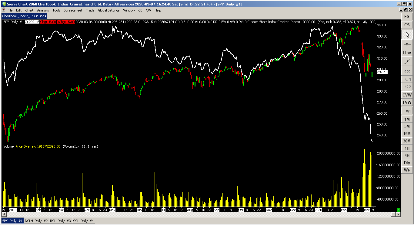

Let's get started with a simple example. You have read the CSIC documentation page by now, right? I usually like to open SPY in a new chartbook with daily bars going 5-10 years back as my base chart.
Cruise Lines. These have gotten pounded the last few weeks. Since there are only 3 main ones, this will make an easy example template. I usually prefer several stocks for a better average for an index, but like I said, there are only 3. We have Carnival (CCL), Royal Caribbean (RCL), and Norwegian (NCLH).
We have a couple ways to proceed: with and without weighting. Without weighting averages all equally and is quick to set up (esp for testing). This makes more of a "psychological interest" based index as a buy in one stock is equally weighted in a buy against another stock in the list. The three main weighting ideas can be mixed. First is how well all the stocks "should" track with each other (mentioned in the main documentation). Second is lowering the weight of a stock where management is doing "bad things" and is inappropriately skewing the index. This could also be raised if they're taking the market. Third is weighting the stock by some calculated metric such as Market Cap. If you've read the documentation, you'll know that any stock without a weight defaults to 1.0.
Note: Since most of us are traders (with some secondary long term holdings), we tend to be vary paranoid about any and all squiggles on the chart. The more paranoid will want to use weightings based on the numbers that you are most familiar with based on your own personalized trading style. Since we all trade differently, there is no one single answer to make everyone happy...
...so here's an example you can modify to your own trading style: weighting by Market Cap. I jumped over to the finance.yahoo pages to get these numbers... but which to use? There's Market Cap for last quarter and there's also a daily calculated Market Cap. The Market Cap table could also be averaged. Since I'm guessing that these three cruise lines are big enough to not go under (pun?), I'm going to choose last reporting quarter. This represents how they were and how they're likely to proportionally be to each other after the coronavirus subsides. As I mentioned above, the #2 option in weighting has the idea of reducing the weight value if something bad happens like bankruptcy... or maybe bump the weight up a little higher if one company positions itself far better than another. On the Yahoo pages are also enterprise value, P/E ratios, revenue, and profits that could be swapped out for Market Cap in this example if your trading models use them. I'll stick with last quarter Market Cap since it's a common weighting and easy to understand.
CCL=$32.12b (2019-11-30, older but still usable)
RCL=$27.99b (2019-12-31)
NCLH=$12.45b (2019-12-31)
Take the largest Market Cap from CCL and we'll set that equal to a weighting of 1.0 (100%). The others will be a fractional percent of CCL in terms of size.
RCL is next, so divide it by CCL: $27.99b/$32.12b = 0.871
NCLH is the last to divide by CCL: $12.45b/$32.12b = 0.388
Note: Order in the Symbol List doesn't matter, but to keep things simple and understandable, stick with the largest Market Cap for the denominator (CCL in this case). Weightings greater than 1.0 are fine if Market Cap changes in the future. There is no artificial limitation.
Note 2: If your stock weighting divides out to less than 0.1 (10% or less the size of the largest by Market Cap), it may not worth being included in the Symbol List since it would be so small. If you still want it and there are other small ones like it, maybe don't use weightings.
...So, the Market Cap weighted Symbol List line to plug into the CSIC study would be:
CCL 1.0, RCL 0.871, NCLH 0.388
...And if you want just a quick look without weightings:
CCL, RCL, NCLH
Note: When changing stocks in the CSIC, set "Close All Other Charts?" to "One Shot" to clean up the chartbook. Everything will reload.
Hit OK in the Study Settings window and Sierra Chart will flash windows about as it loads the data in the background. This can take a minute. See the main documentation for the gotchas. You did read that, right? You can also add volume, which I find to be handy, in a second chart region.
(See attached image file)
Once done, you'll see bars from SPY and a white line overlaid on top of it for the cruise line index. From the beginning of 2019 to Friday's last trade (March 6), you'll see a semi-smashed head and shoulders pattern. For Friday, there was a slight turn up to the free fall. In Elliott Wave Theory (EWT), this is somewhat expected as it is almost half the length of the first free fall. EWT states there could be another half length fall before bottom. Stepping back from technical analysis, given that giant ships are locked in petri dishes for illness, this is likely... but who knows? Cruise ships are likely to bounce back last, so this would be a trailing indicator index. When the other indexes are turning up, the potential play would be to buy into your favorite cruise line when its down trend line breaks. Remember that the index line uses relative numbers and won't match to any specific dollar values. What's important is the pattern. You did read the CSIC documentation, right?
Note: If you don't like SPY, you could use your favorite cruise line as the base chart and compare it to the others using the created index line. This would create a better/worse performance comparison based on the company's peers (I usually call this a peer index).
If you like the chart, I recommend saving it something like: Index_CruiseLines.cht. Using "Index_" as a prefix keeps them all together in the file list. A bunch of these index files can get really messy without some forethought.
Since setting up CSIC can be a little tedious, saving this simple example as "Index_Template.cht" can make things go faster in the future. Just load it into a new chartbook for the next one, do the "One Shot" close mentioned above, and enter the new Symbol List. Remember to hit "Save As" if you want to keep a new index instead of saving over the template.

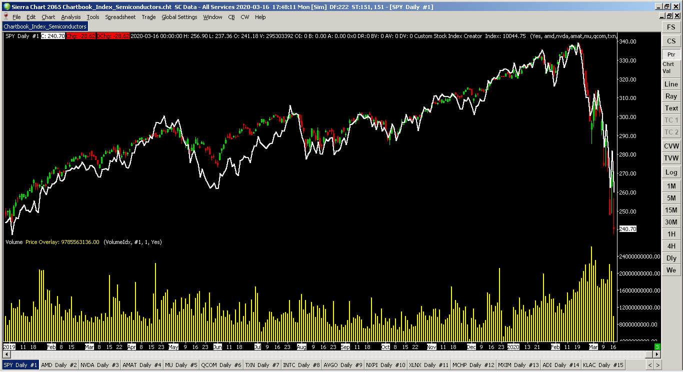

Semiconductors: AMD, NVDA, AMAT (Applied Materials), MU (micron), QCOM, TXN (Texas Instruments), INTC (Intel), AVGO (Broadcom), NXPI (NXP Semi), XLNX (Xilinx), MCHP (Microchip), MXIM (Maxim), ADI (Analog Devices), KLAC (KLA Corp), LRCX (Lam Research)
Symbol List: AMD, NVDA, AMAT, MU, QCOM, TXN, INTC, AVGO, NXPI, XLNX, MCHP, MXIM, ADI, KLAC, LRCX
Thoughts: Since we're all addicted to tech, these will likely bounce back first. When the coronavirus starts subsiding, factories will start to re-open and become productive again. Most factories are in China or southeast Asia.

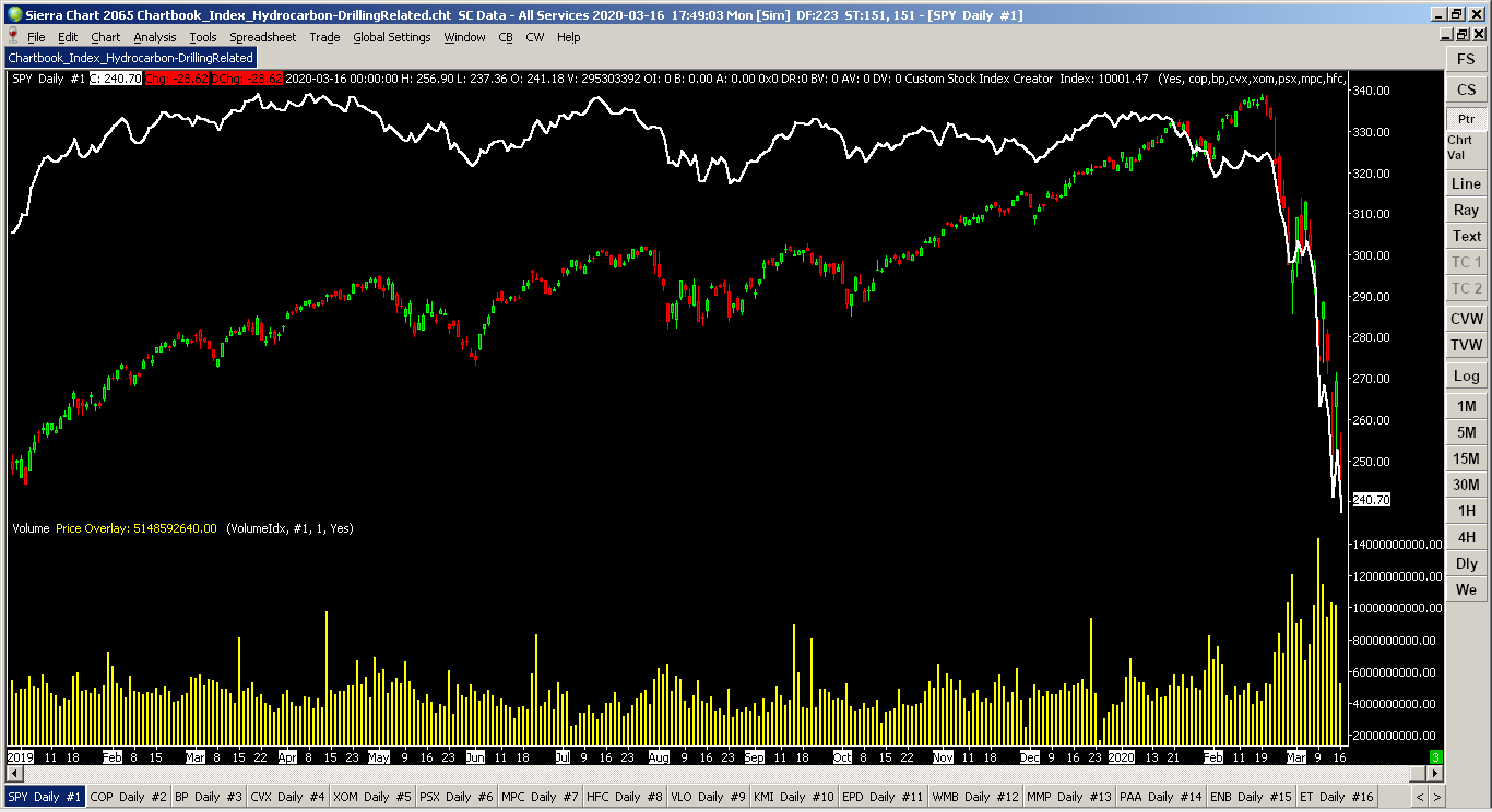

Updated airlines, semiconductors, and split the old petrol list into the hydrocarbon lists.
Added pics of semiconductors and hydrocarbon/drilling.

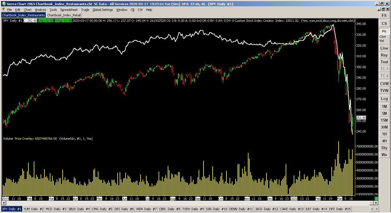

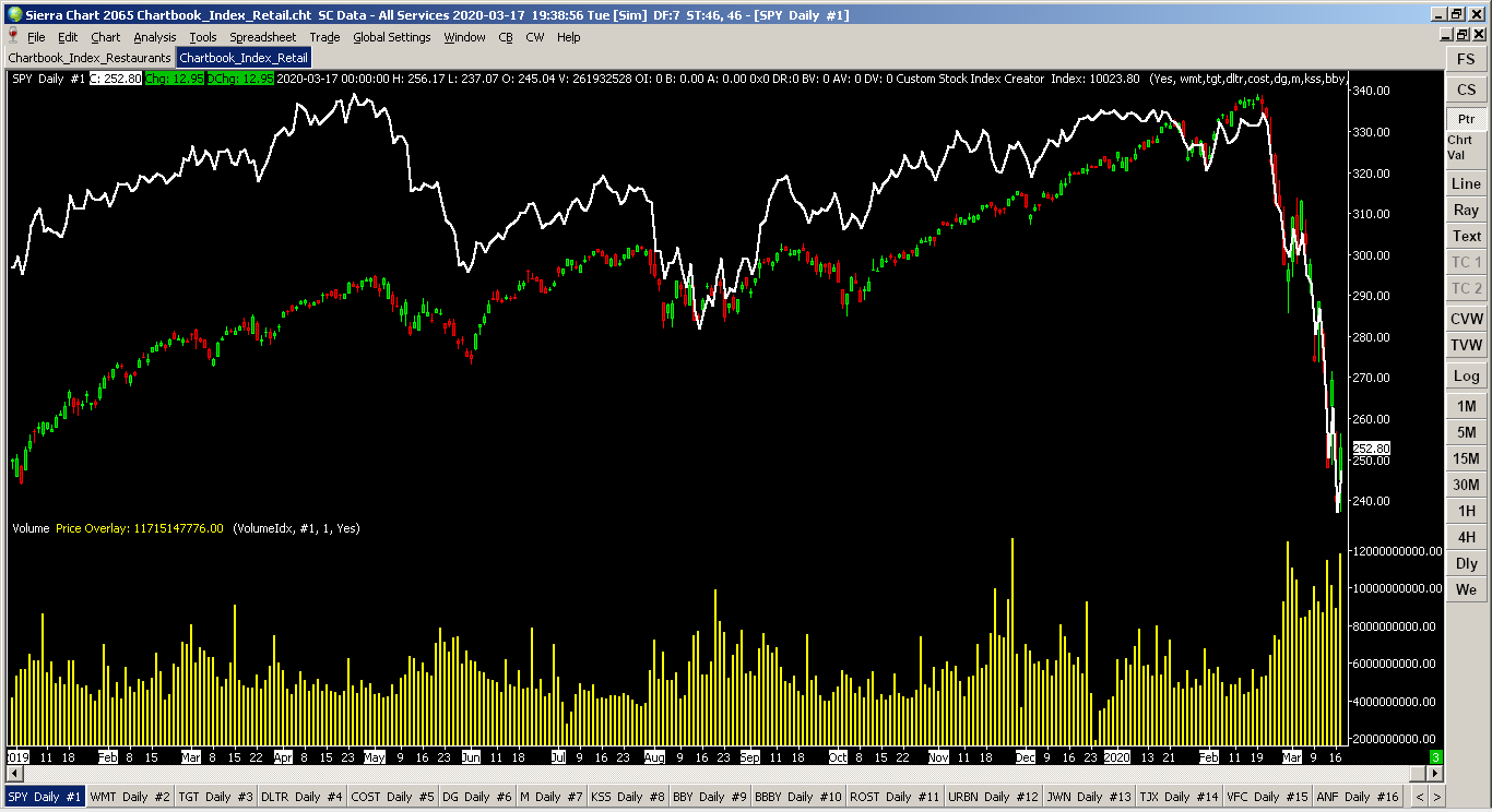

Adding... (pics of Restaurants and Retail attached)

Retail: WMT (Wal-Mart), TGT (Target), DLTR (Dollar Tree), COST (Costco), DG (Dollar General), M (Macy's), KSS (Kohls), BBY (Best Buy), BBBY (Bed Bath & Beyond), ROST (Ross), URBN (Urban Outfitters), JWN (Nordstrom), TJX, VFC, ANF (Abercrombie & Fitch), RL (Ralph Lauren), AEO (American Eagle Outfitters), GPS (The Gap), TIF (Tiffany), LB (L Brands), GES (Guess), FL (Foot Locker), HBI (Hanesbrands), TPR (Tapestry), CPRI (Capri), UA (Under Armour), LULU
Symbol List: WMT, TGT, DLTR, COST, DG, M, KSS, BBY, BBBY, ROST, URBN, JWN, TJX, VFC, ANF, RL, AEO, GPS, TIF, LB, GES, FL, HBI, TPR, CPRI, UA, LULU
Thoughts: Some are stronger than others. Some are in more critical areas than others. Retail will be volatile.

Restaurants: YUM, MCD (McDonalds), SBUX (Starbucks), CMG (Chipotle), DRI (Darden), WEN (Wendy's), CBRL (Cracker Barrel), TXRH (Texas Roadhouse), DIN (Dine), DENN (Denny's), JACK (Jack in the Box), CAKE (Cheesecake Factory), EAT (Brinker), DPZ (Domino's Pizza), PZZA (Papa John's), DNKN (Dunkin' Brands), QSR (Restaurant Brands), SHAK (Shake Shack)
Symbol List: YUM, MCD, SBUX, CMG, DRI, WEN, CBRL, TXRH, DIN, DENN, JACK, CAKE, EAT, DPZ, PZZA, DNKN, QSR, SHAK
Thoughts: These will be hit the hardest with isolation orders. Food venues with drive-thru will do better than sit-down only. Once the orders are lifted, these will bounce back.
