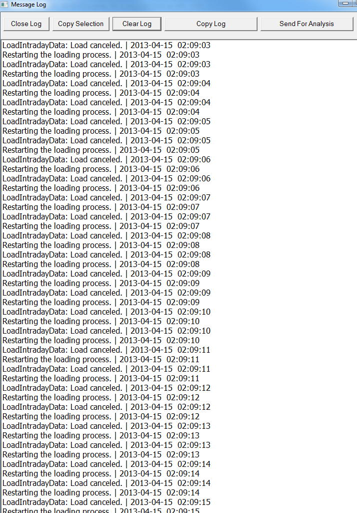

I updated to 965 but the same pb as you can see in the log. Regards Outlander
