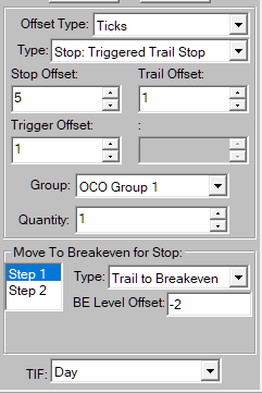

If I set Triggered Trailing Stop without any Trail to BE settings, then the TTS works as expected.
But if I add the Trail to BE component, then the TTS does not respect the Trail Offset = 2 setting. Rather it trails at 5 ticks. It appears to be using the Stop Offset value instead.
If I remove the Trail to BE settings, then the TTS again works as expected.
Second question: how do I set a Bid Ask Volume Quantity triggered stop that is also trailing?
Date Time Of Last Edit: 2020-03-06 02:39:52
imageAnnotation 2020-03-06 113751.png / V - Attached On 2020-03-06 02:38:10 UTC - Size: 13.09 KB - 382 views
[2020-03-08 08:19:20]
Letting you know this is still pending review.

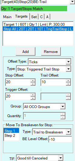

User432142 - Posts: 44
l have a same below problem
"If I set Triggered Trailing Stop without any Trail to BE settings, then the TTS works as expected.
If I remove the Trail to BE settings, then the TTS again works as expected."
image2020-04-28_15-56-46.jpg / V - Attached On 2020-04-28 06:58:08 UTC - Size: 69.14 KB - 365 views
[2020-04-30 10:37:22]
We are working on a solution to this. It will be out in the next release.
