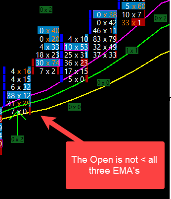

I'm getting some random false positives from my IF statement below. I want the statement to put a 1 in column if the bar Open is < the three EMA's (ID11, ID12, ID15). And the opposite should produce a -1. However, about 95% of the signals are correct, but every now and then, a false signal appears. See example in attached screenshot.
=IF(AND(B3<ID11.SG1@3,B3<ID12.SG1@3,B3<ID15.SG1@3),1,IF(AND(B3>ID11.SG1@3,B3>ID12.SG1@3,B3>ID15.SG1@3),-1,U4))
Thank you,
Tom
imageEMA5_8_13.png / V - Attached On 2020-03-05 21:19:40 UTC - Size: 20.86 KB - 343 views

Upon closer look at that formula, it won't change to the opposite polarity until B3 has made the full transition to the other side, so there will be some false positives in between.
You could just use two columns:
=IF(AND(B3>ID11.SG1@3,B3>ID12.SG1@3,B3>ID15.SG1@3),1,0)
=IF(AND(B3>ID11.SG1@3,B3>ID12.SG1@3,B3>ID15.SG1@3),-1,0)
If you want the formula in only one column, you'll need a third condition, rewritten using MAX and MIN functions:
=IF(AND(B3>=MIN(ID11.SG1@3,ID12.SG1@3,ID15.SG1@3),B3<=MAX(ID11.SG1@3,ID12.SG1@3,ID15.SG1@3)),0,IF(B3<MIN(ID11.SG1@3,ID12.SG1@3,ID15.SG1@3),1,IF(B3>MAX(ID11.SG1@3,ID12.SG1@3,ID15.SG1@3),-1,U4)))

tommartin321 - Posts: 81
Yes, that works. Thanks tom
