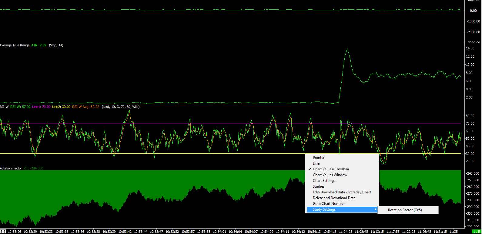

i added a spreadsheet study to my chart and it created the spreadsheet tab but also created an empty region 3, i assume to chart my calculations... i removed the spreadsheet stdy and the tab but region 3 has stayed..
how do i get rid of the region left by spreadsheet study?

You must have some other study still on the chart that is set to display in Chart Region 3. Look through all the studies for that chart and see if you can find it.
[2020-03-03 18:25:28]
Ackin - Posts: 1865
Faster searching:
Right-click in the region area and look at “Study Settings”. You will only see the studies used in the region.
This works also for "Hide studies".

i recreated the chart with same indicators and SS study... when i remove the SS study it does remove region 3 and SS tab
i since replace the region 3 with another indicator and it seems to be the only one there so not sure what happened, probably on my end... thanks
