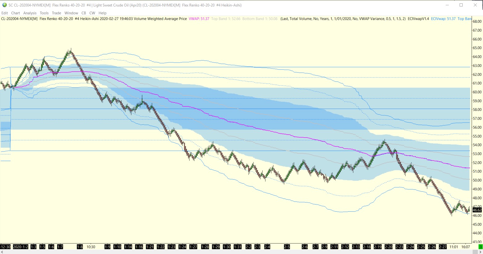

Hi.
Im using ECIVwap, to calculate VWAP for CL futures yearly and quarterly. but apparently the value is wrong (around 52), I have check the same VWAP value in Ninjatrder 8 and tradingview and the value is arround 54.
Can you help to try to identify the problem. i using Data from sierra charts (Denali Exchange Data Feed) trading evaluator.
Thanks for your time and help.
I attached a print screen.
imageECI VWAP.jpg / V - Attached On 2020-02-27 10:59:13 UTC - Size: 229.23 KB - 1254 views
[2020-02-27 18:57:37]

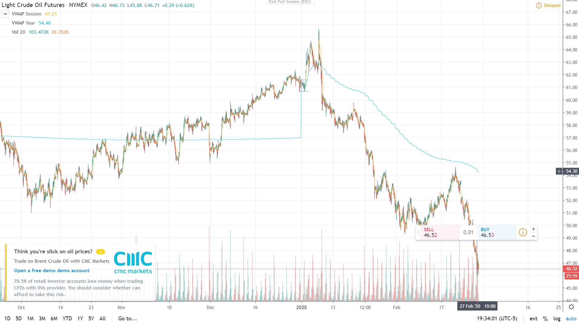

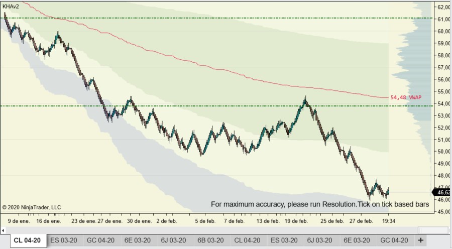

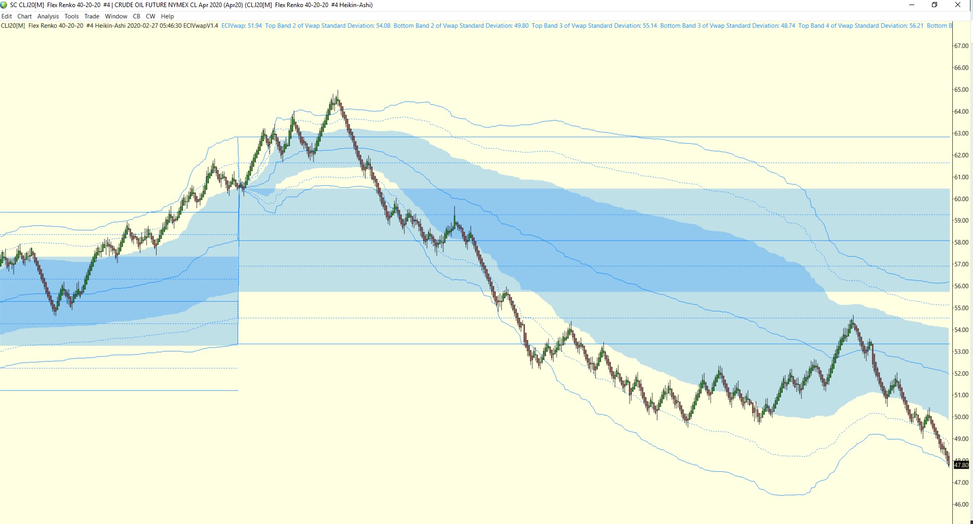

I attached the charts and you can see what im telling you.
I think the problem is relate with yearly chart, data.
I apreciatte your help.
imagetradingviw vwap yearly CL futures.jpg / V - Attached On 2020-02-28 01:12:41 UTC - Size: 267.87 KB - 572 views
imageVwap yearly NT 8 Cl futures.jpg / V - Attached On 2020-02-28 01:12:53 UTC - Size: 81.58 KB - 927 views
imagevwap Yearly Sierra Charts CL Futures.jpg / V - Attached On 2020-02-28 01:13:03 UTC - Size: 200.85 KB - 531 views
