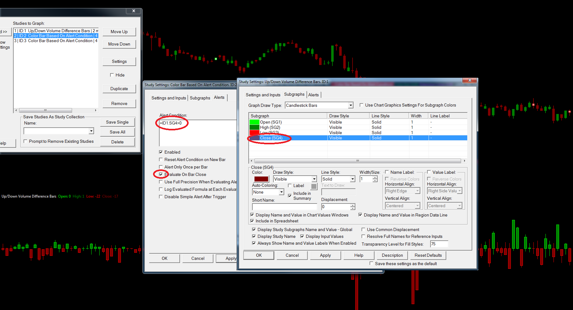

I want to create a condition with Color Bar Based On Alert Condition.
I use up/down volume different bars,I want to created formula IDx[-1].SGx<0, but it's wrong.

See the attached picture
imagecolorbar AB.png / V - Attached On 2020-02-21 12:28:50 UTC - Size: 152.26 KB - 462 views

User509345 - Posts: 44
Thanks, I know ID.SGx<0, but ID[-1].SGx<0, it's wrong.
I have highlighted ID.SGx>0 and ID.SGx<0 combine vwap.
