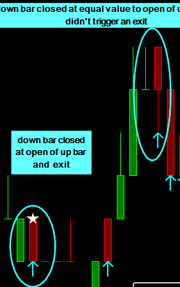

Thanks for the feedback Tomglib, I set the number format for the O, H, L, Last to 0.01 in ES chart and all the studies as well but still same some cases didn't improve. The exit condition is when in a long trade a down bar takes place at lower or equal to the open of the previous bar then exit triggers.. I have attached an image.

[2020-02-14 22:58:33]
Sawtooth - Posts: 4354
The Number Format does not remove floating point errors. It is only for display.
Did you do this to remove the imprecision?:
Using the Spreadsheet Study: Rounding of Values to Tick Size

[2020-02-15 03:28:31]
Do this:
Set 'Number of Formula Columns to something 20 or larger.
Put this in H21:
=1/ROUND(1/J21,0)
Put this in AB3:
=MROUND(B3,$H$21)
Put this in AC3:
=MROUND(C3,$H$21)
Put this in AD3:
=MROUND(D3,$H$21)
Put this in AE3:
=MROUND(E3,$H$21)
Now reference OHLC values that are rounded to the rounded tick size, using AB3, AC3, AD3, AE3, respectively.
(You only need to use the ID#.SG#@[row] format when referencing study outputs. Use cell/row references for all others. This keeps things tidier.)
[2020-02-15 07:37:14]
User190501 - Posts: 98
Thanks a lot for the idea of rounding to the tick size and the coding style tip.
