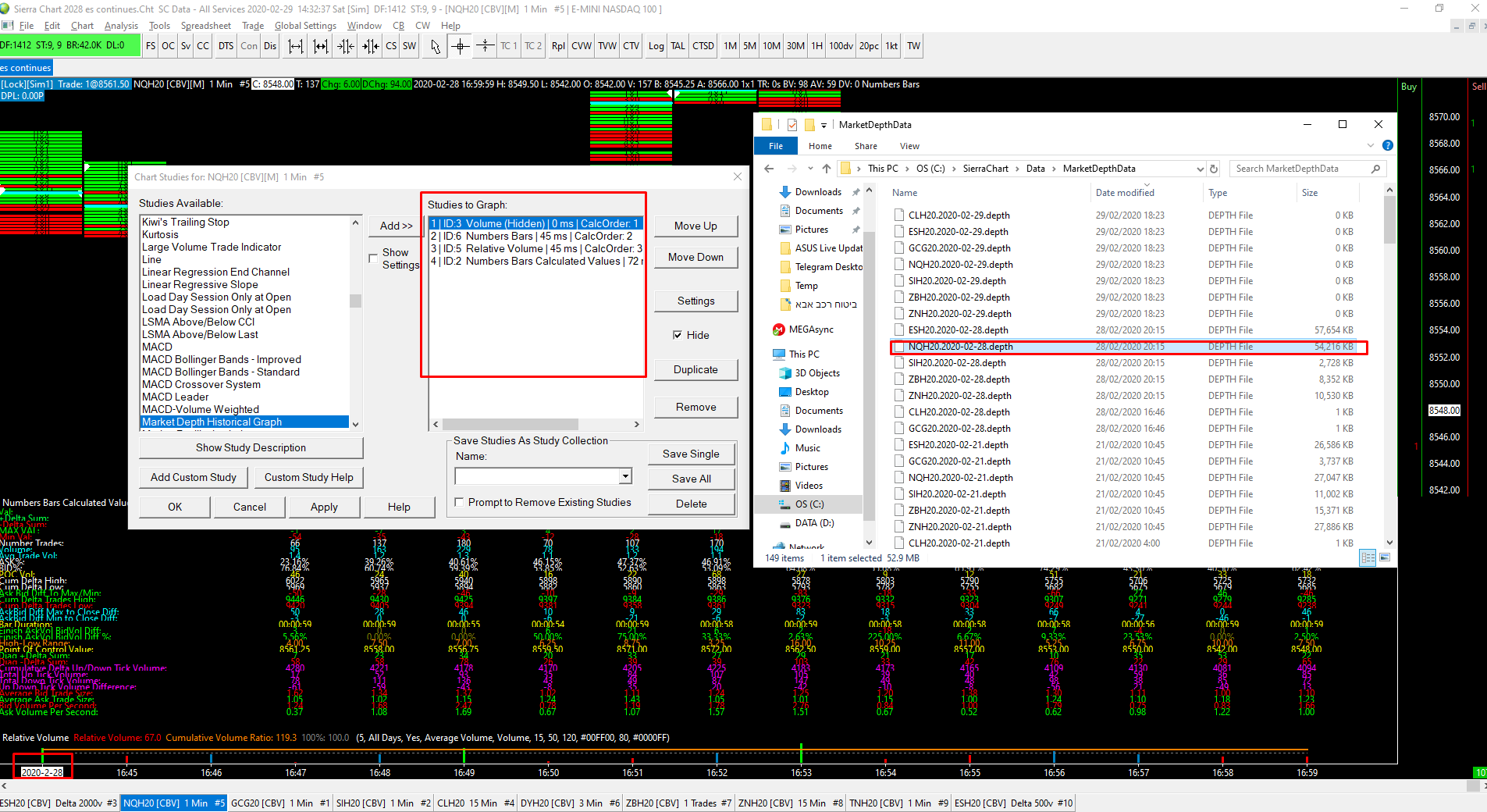

[2020-02-29 19:34:42]
User61576 - Posts: 458
pls check screenshot attached
i removed the indicator and yet the depth data keep being saved
pls advice
thanks

[2020-03-04 02:59:55]
Sierra_Chart Engineering - Posts: 25048
Did you remove it from all of the charts?
[2020-03-04 06:14:42]
the only chart I forgot to remove it from was DYH20 which never got depth data anyway. I did remove it from all cme symbols but b/c I didn't remove from a symbol which doesn't get any depth data in the first place than all the other symbols kept saving the data
this was a weird thing...
