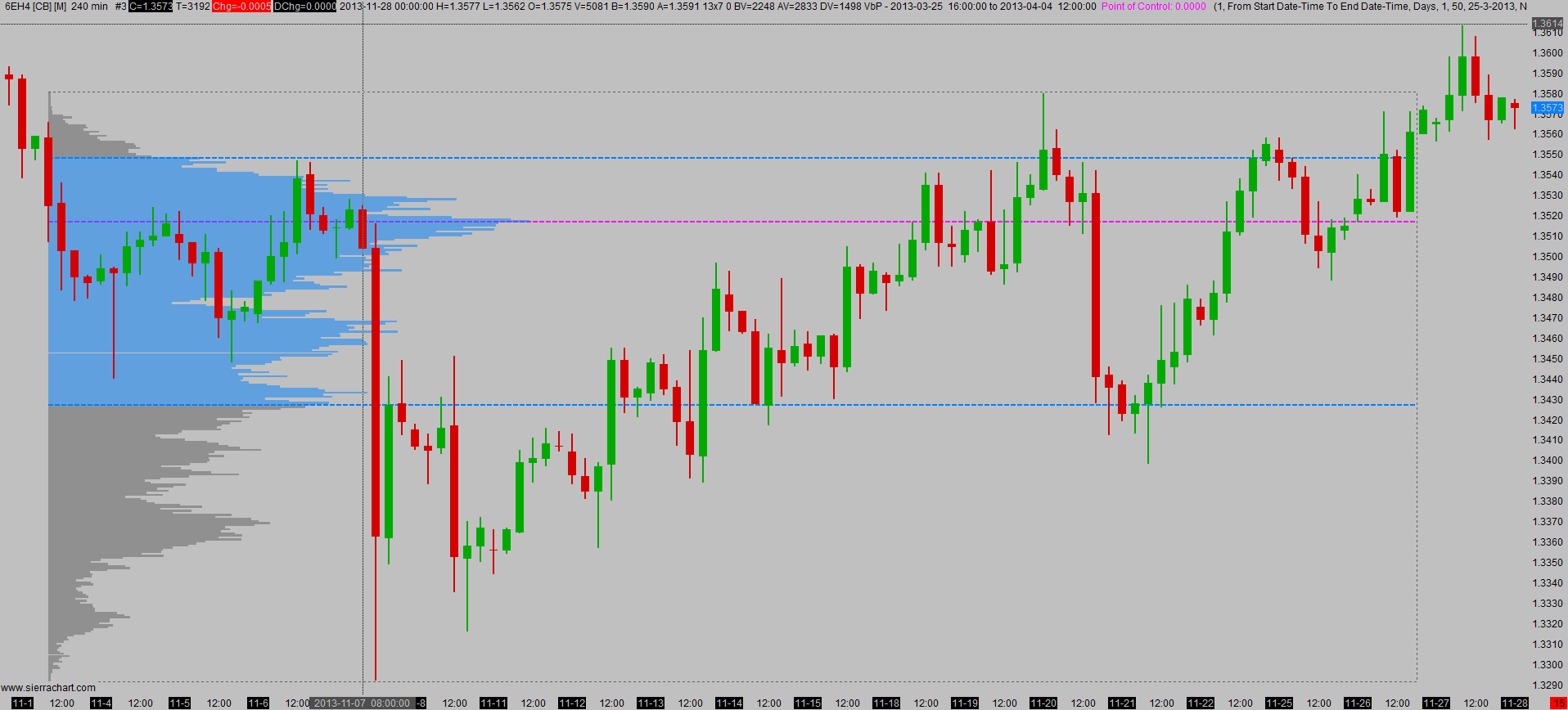

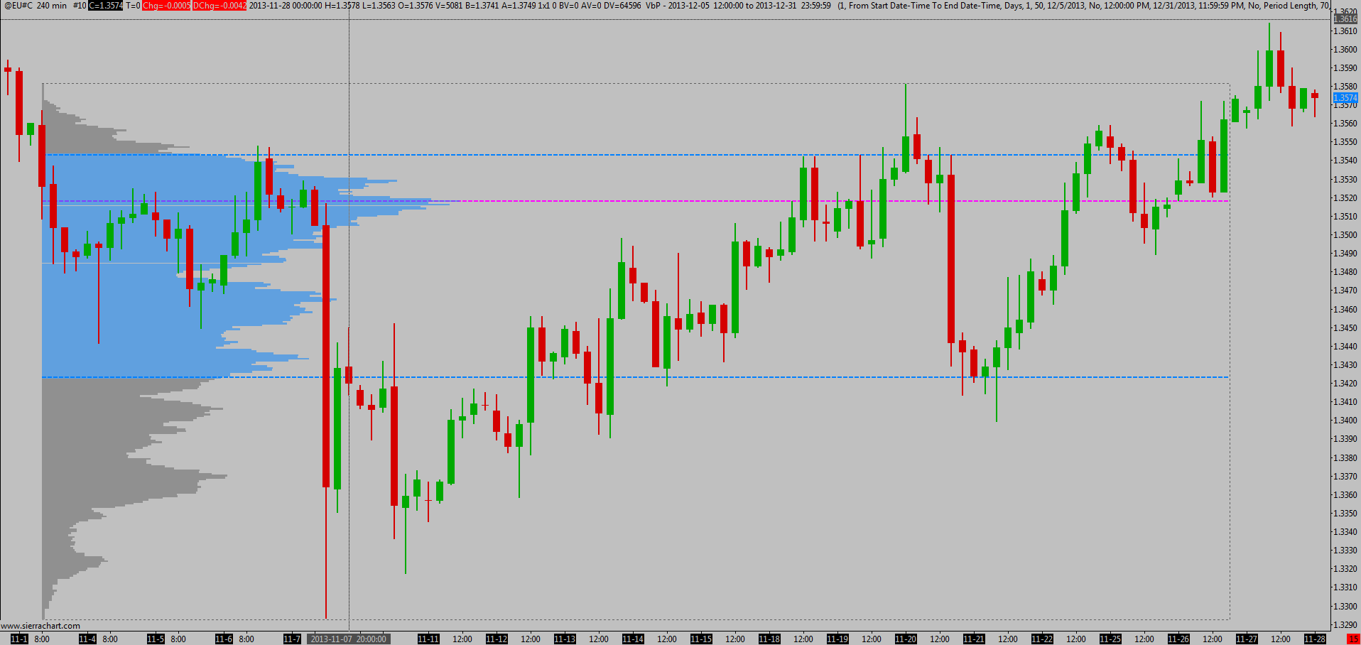

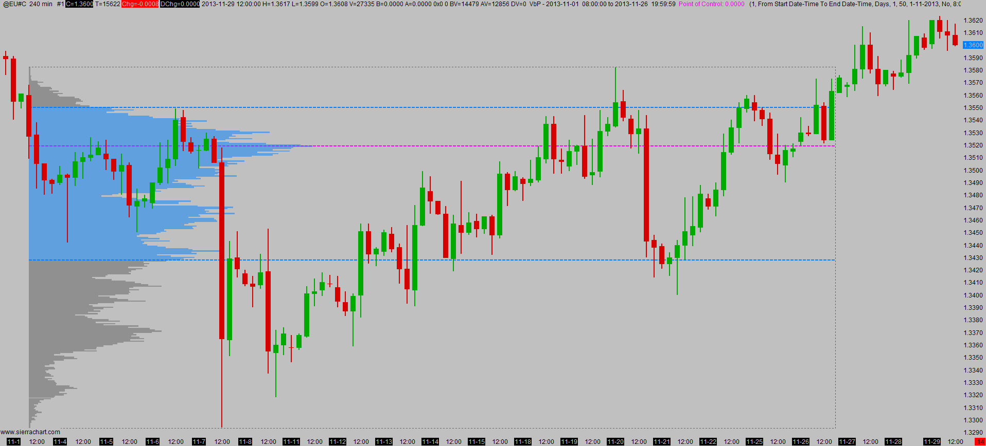

I notice differences in volume profiles for 6E between SC feed and IQFeed:
http://www.sierrachart.com/image.php?l=1388966880899.png (SC Feed 6EH4 continuous back adjusted volume based, no difference with date rule based)
http://www.sierrachart.com/image.php?l=1388966818395.png (IQFeed EU#C continuous back adjusted).
The settings for both are the same for VbP as well as the data configuration (tick by tick).
The data from the SC feed was freshly loaded, the data from IQFeed is from Dec 31st. I cannot reload it as I have cancelled my subscription. That said, I haven't noticed data anomalies in the past fwiw.
The question now is which one is an accurate representation of reality. Please advise.

One question we have is whether the data from IQ feed is actually tick by tick. During market hours they have a limitation of 8 days of tick data. So you could have some minute data. The other thing is you need to be certain certain that the rollover point is exactly identical.
So you are saying you do not notice any difference with date-based rollover? Also, the settings are different between these two profiles. That is clear.
Really this question is getting outside the scope of our support. We are not really sure what the purpose of the question is. You are in a better position to really know what's going on because you created the profiles. We are at a disadvantage.

PTG - Posts: 57
"One question we have is whether the data from IQ feed is actually tick by tick.
That's a fair point. The .scid file I downloaded is dated 1/1/2014 12:39 AM (GMT+1). The size is 82.589 kB. It starts July 10th 2008. How can I check if the file is actually tick by tick ?

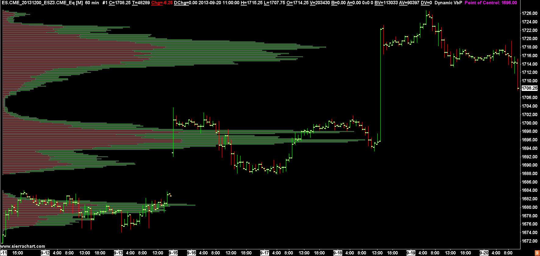

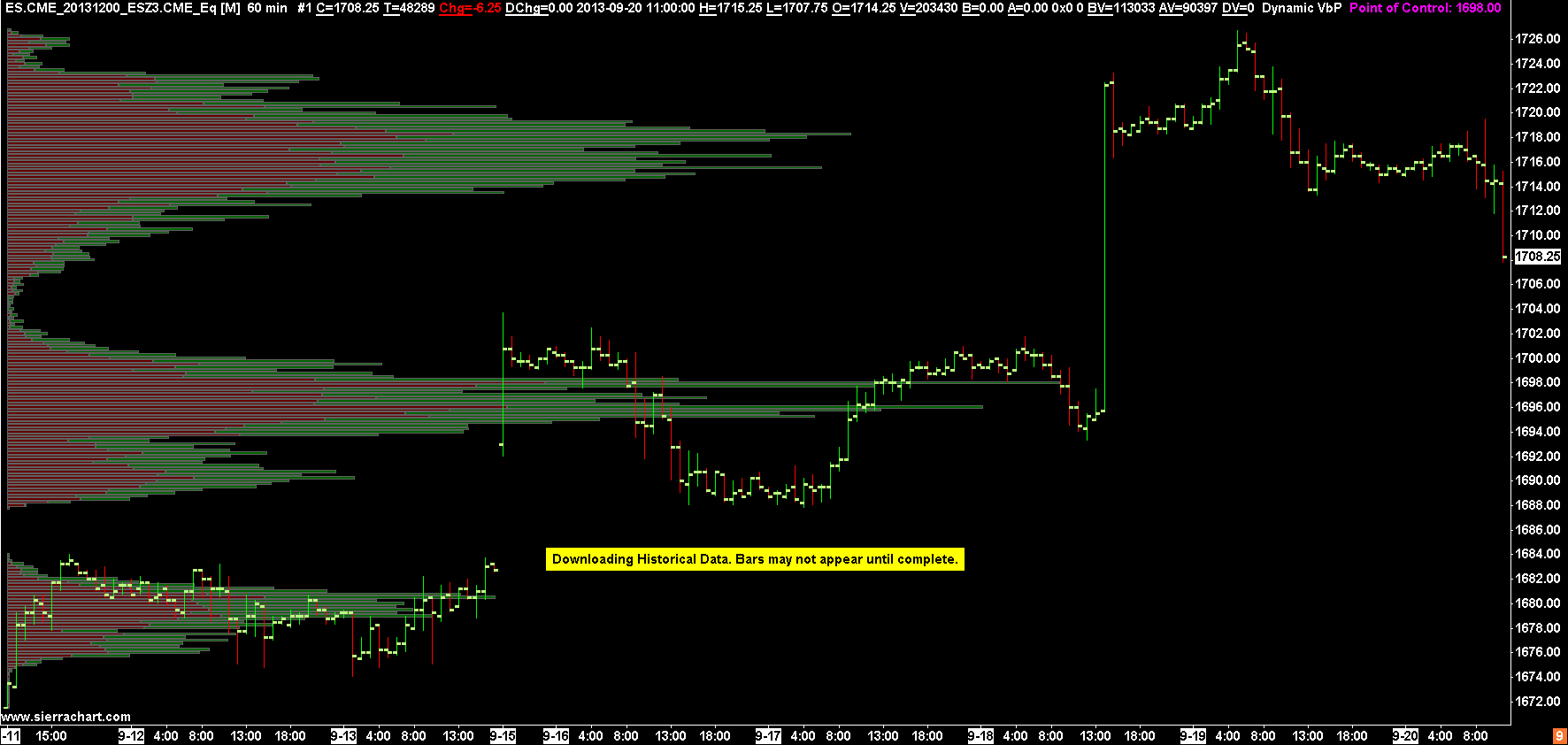

One thing we observed in your chart images is that the IQ feed volume profiles have a smoother appearance on the right side. We wondered what this meant. If you have a look at the below images, you can see that 1 Minute data has a smoother appearance on the volume profiles compared to the 1 tick data.
Minute data:
http://www.sierrachart.com/image.php?l=1389154101693.png
1 Tick data:
http://www.sierrachart.com/image.php?l=1389154202956.png
What this means, is that the Sierra Chart Volume Profiles are far more accurate than what you have with IQ Feed. There simply is no comparison here. The market data platform that we have developed, is on a much higher standard than IQ Feed.

LOL. I'm not on your side of this SB but I can imagine what is going on very well. It is extremely difficult to communicate about issues. You are dealing with individuals with various competence levels in unique circumstances.
Yes, I see that. They are from ES though, not 6E. I wonder why they aren't identical. I'd suggest to check the VbP settings (no pun intended ;) )

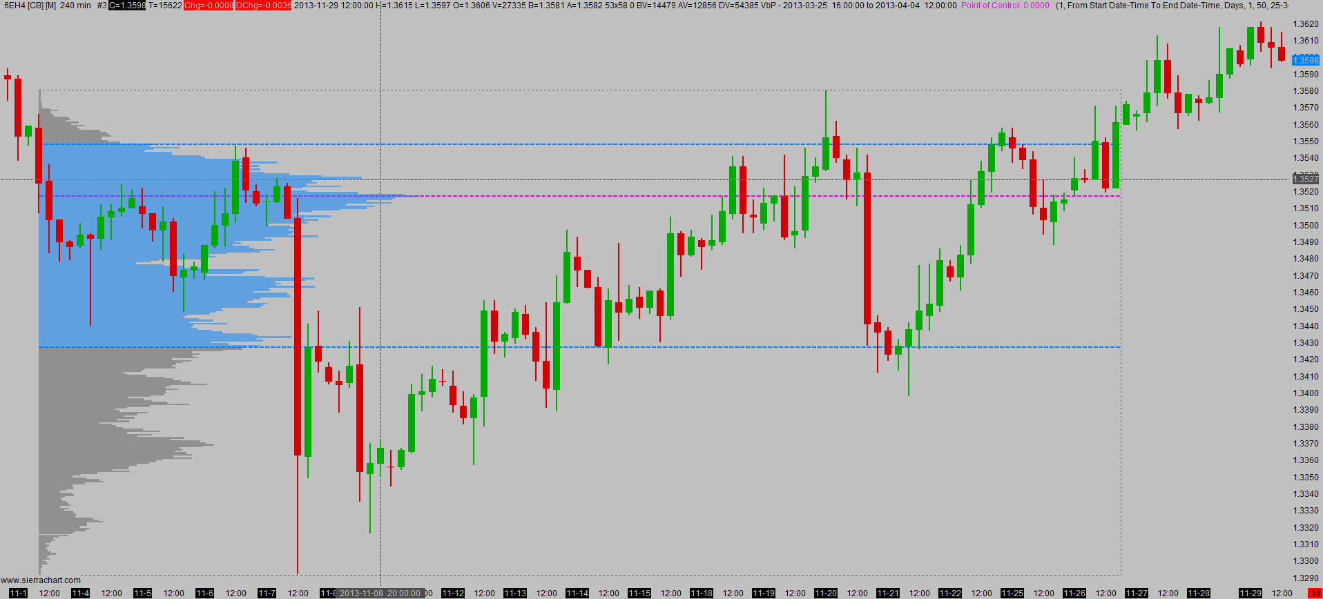

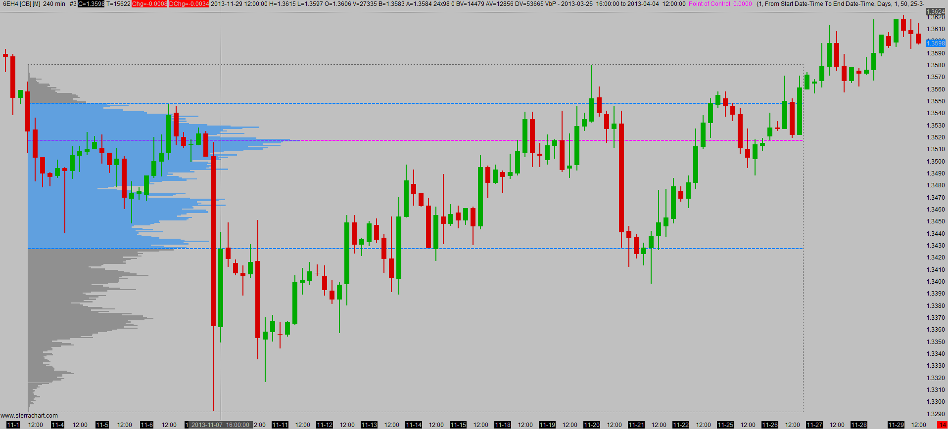

I have set the Intraday Data Storage Time Unit to 1 minute, and performed a Delete All Data And Download. The resulting profile is the following: http://www.sierrachart.com/image.php?l=1389181375573.png This is SC feed data.
I then have set the Intraday Data Storage Time Unit back to 1 tick, and performed a Delete All Data And Download once more. The resulting profile is the following: http://www.sierrachart.com/image.php?l=1389181863993.png This is SC feed data.
There is no difference. I'd expect this since the VbP would only differ if the time unit considered were smaller than 1 minute, which is not the case. As I see it, it makes no difference if you add up VbP over a period of days based on intraday data records containing tick data vs. minute data, as long as the period is a multiple of minutes. Note that the file size for 6EH4.scid was 44.676 Kb for tick data vs. 728 Kb for minute data so the delete and download data did actually take place. Please correct me if I'm seeing it wrong.
We are referring to the Volume by Price settings. They are different in your charts.
Most definitely not: they are the same. 100%.
I'm afraid all this is much simpler. The difference is in the .scid file from IQFeed on the computer I made the original screenshot from. After performing the above, I suspected the IQFeed based .scid file. I found another .scid file for IQFeed's @EU#C on another computer, fortunately. I hadn't thought of that since it wasn't supposed to be there. The screenshot for the profile based on that IQFeed .scid file is this: http://www.sierrachart.com/image.php?l=1389183997321.png Compare this with any of the two above (both are based on SC data), and the differences are rather small, something that I'd expect.
I have no idea why the .scid file on the other computer is off. It shouldn't be, but it is what it is. This appears to be the cause for the difference.
All in all I have my answer. I'm confident about the SC data. That said, I don't understand why I see identical profiles for tick- and minute data on 6E where you see different profiles on ES.

There must be a difference. There is 0% chance they would be the same. We understand exactly how this works and there will be a difference for sure. In our own test we have proved that. Since we do not know exactly what you have done in your test, we cannot comment on your results.
Look at the top line of the chart images you have given in post #1. You can clearly see that the input settings for each of the Volume by Price studies are different. If those input settings we are seeing are for another volume profile that we cannot see, then you have overly complicated the image and have confused things. This is what causes such a problem for us.
It's not about the top lines. It's about the actual settings for the volume profiles displayed. I've been talking about the profile starting 0800 on Nov 1st 2013 all the time. How can you conclude the settings for SC and IQ are different based on the top line ?
Perhaps it is the fact that I have more profiles on the chart which I have hidden ?

The study settings for the profiles displayed (F6 and select the applicable profile) are the same for the charts displayed.
There is a 0% chance they are different. I'm perfectly capable to compare two F6 - Settings - Settings and Input and Subgraphs and Alerts. It's not that difficult you know. I'm not retarded, or so I hope. I'm happy to send you screenshots of the settings - they are the same. 100% the same. As in: identical. The only thing different is the data loaded - 1 minute vs. 1 tick data.
Between http://www.sierrachart.com/image.php?l=1389181863993.png and http://www.sierrachart.com/image.php?l=1389181375573.png there is no difference, once again.
I have many profiles on my charts. The top line is probably not indicative. If I tell you the settings are the same for a particular profile, you can believe me on my word. I am not wasting my time on BS, or am I. There is no reason to suppose I am overcomplicating things.
