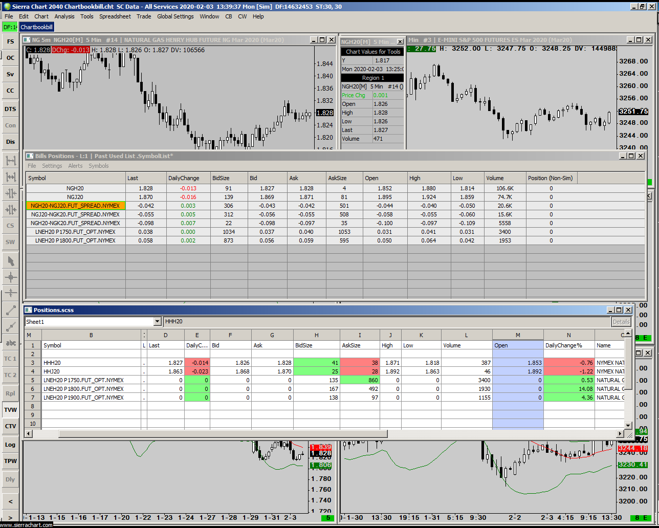

in regards to your response. This overly time consuming the issue is with the quote spread sheet(see below) not quote board.
http://www.sierrachart.com/image.php?Image=158075517875.png
