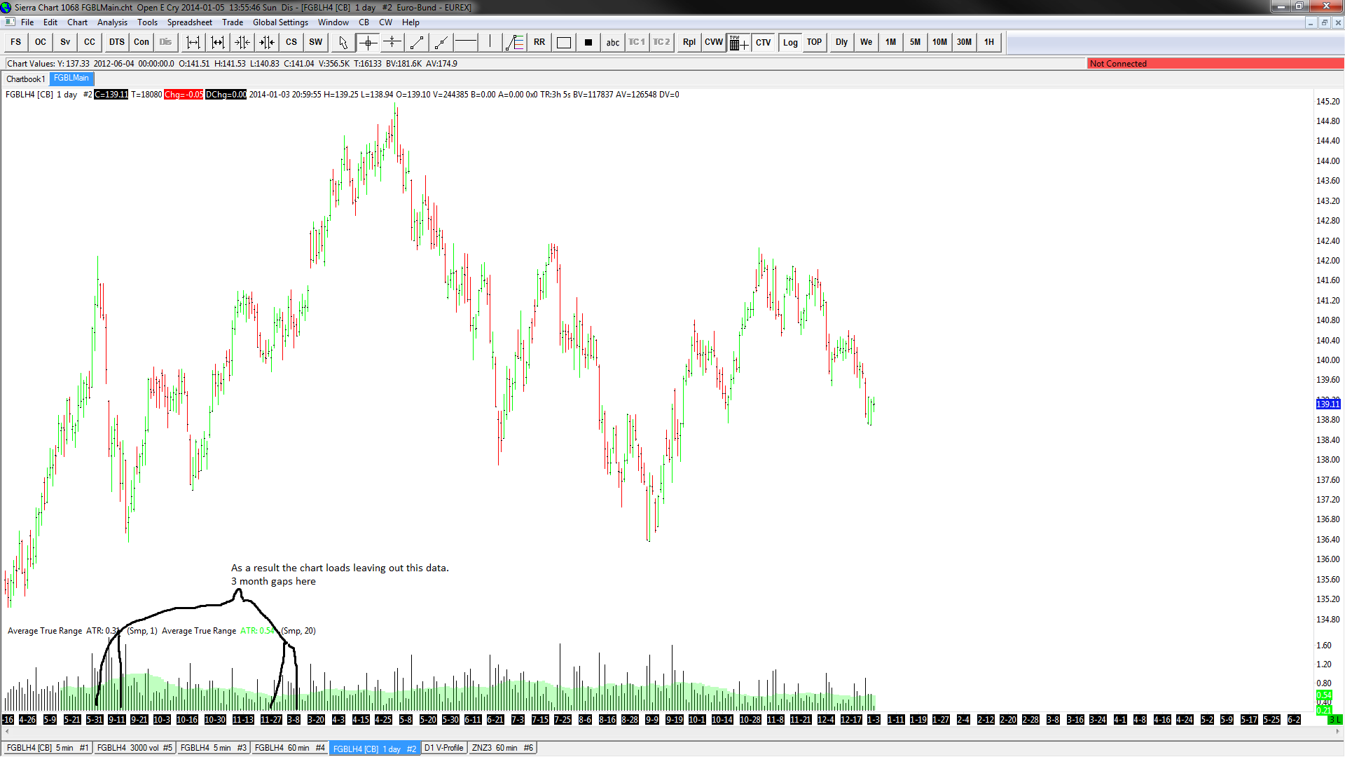

4) Open a chartbook which includes a intraday chart ranging all FGBL contracts FGBLM2 - FGBLH4

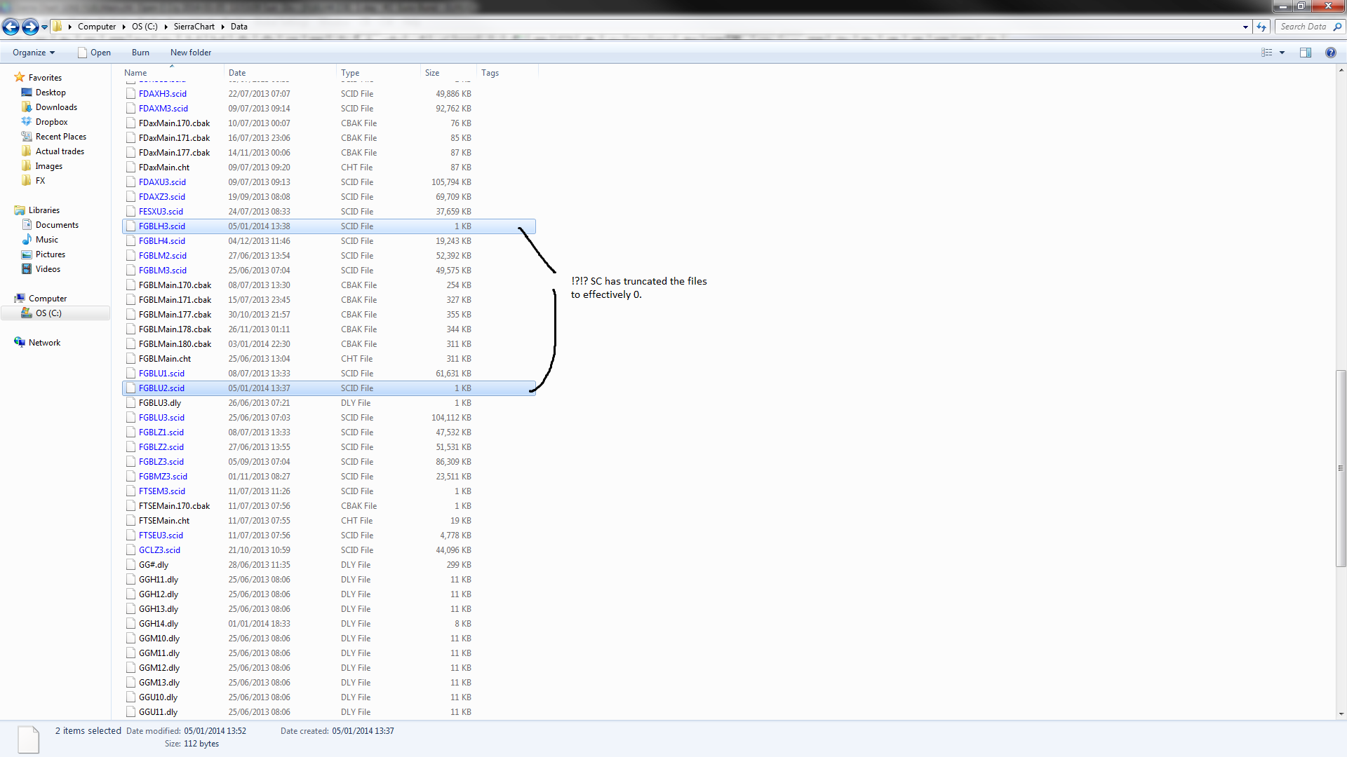

5) For some reason SC then truncates specifically the FGBLU2 and FGBLH3 files to zero length, but loads everything else ok. (screen shot 2)
6) Resulting continuous chart then has missing 3 month gaps where data from these 2 contracts should go (screen shot 3)

HD Request # 5 - Downloading Intraday chart data for FGBLH3 to the file FGBLH3.scid. Service: oec | 2014-01-05 13:52:55
HD Request # 5 - Truncating file to starting Date-Time. | 2014-01-05 13:52:55
HD Request # 5 - Error reading last record after truncate. Error: No record at index -1. | 2014-01-05 13:52:55

HD Request # 6 - Downloading Intraday chart data for FGBLU2 to the file FGBLU2.scid. Service: oec | 2014-01-05 13:52:55
HD Request # 6 - Truncating file to starting Date-Time. | 2014-01-05 13:52:55
HD Request # 6 - Error reading last record after truncate. Error: No record at index -1. | 2014-01-05 13:52:55

imageScreen shot 1.png / V - Attached On 2014-01-05 14:05:33 UTC - Size: 172.8 KB - 643 views
imageScreen shot 2.png / V - Attached On 2014-01-05 14:05:43 UTC - Size: 172.19 KB - 729 views
imageScreen shot 3.png / V - Attached On 2014-01-05 14:05:50 UTC - Size: 107.52 KB - 639 views

This problem has already been resolved. Update Sierra Chart by selecting Help >> Download Current Version.

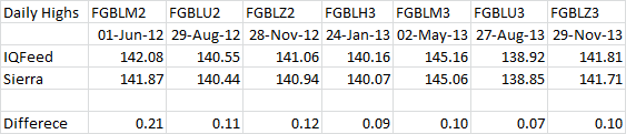

As for the difference to IQFeed:
This could be just due to Open E-Cry. The symbol settings by default for rollover are:
Number of Calendar Days before friday count within contract month
Number of calendar days = 0
Friday count within contract month = 3
This makes no sense. Trading largely shifts onto the new contract on the last day / last 2 days. The last day to trade is a half day session that ends at 12:30CET. I'm rolling the chart over so that the morning of the last day to trade, I am on the new contract, as I'm not interested in the low volume half day session on the old contract. I only seem to be able to achieve this by using the following date rollover rule:
Number of business days before specific calendar days before contract month
Number of business days = 1
Specific calenday days before contract month = -8 (minus 8).
This gives me the dates as per the log above, which I see as correct. Please advise if there is a better way to achieve this.
However, the resulting chart then doesn't match IQFeed. (I deleted & downloaded all data for the series of contracts making up the continuous chart to make sure the problem wasn't some adjustment I did)
As for the differences, I obtained a daily high from an IQFeed continuous chart for all the contracts making up my chart. Comparing these to the Sierra result, I get a result as per the attached comparison.png.
imagecomparison.png / V - Attached On 2014-01-05 20:19:53 UTC - Size: 6.62 KB - 757 views

However, this still left the resulting charts looking different to what IQFeed apparently has (as per that comparison.png)

Once we get this working, we will look more closely at why there is a difference to IQ Feed. Must be something about the back adjustment calculations.
