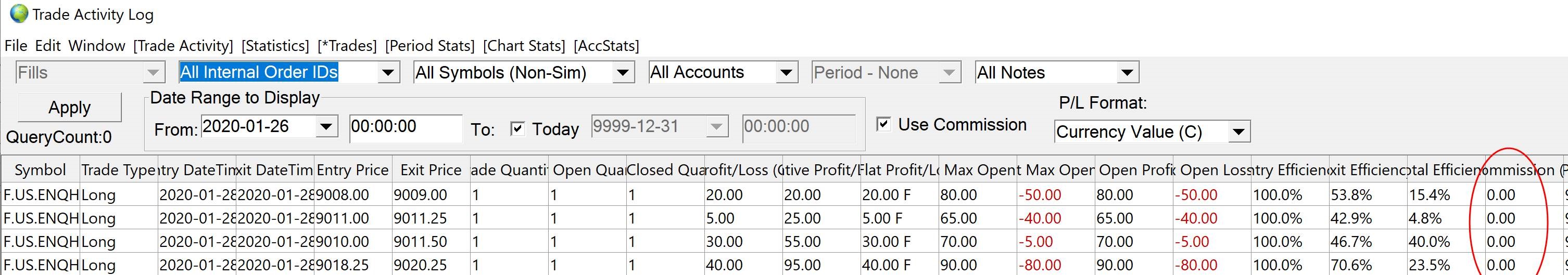

I am having technical problems with getting the Commission to show up and update on the Trade Activity Log, so my cumulative Net Profit is wrong.
See the circled column in the Trade Activity Report attached.

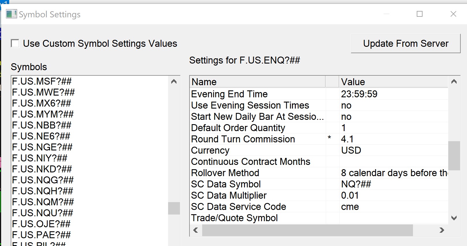

I have updated the Symbol Settings with the round turn commission applicable. Pic 2 attached

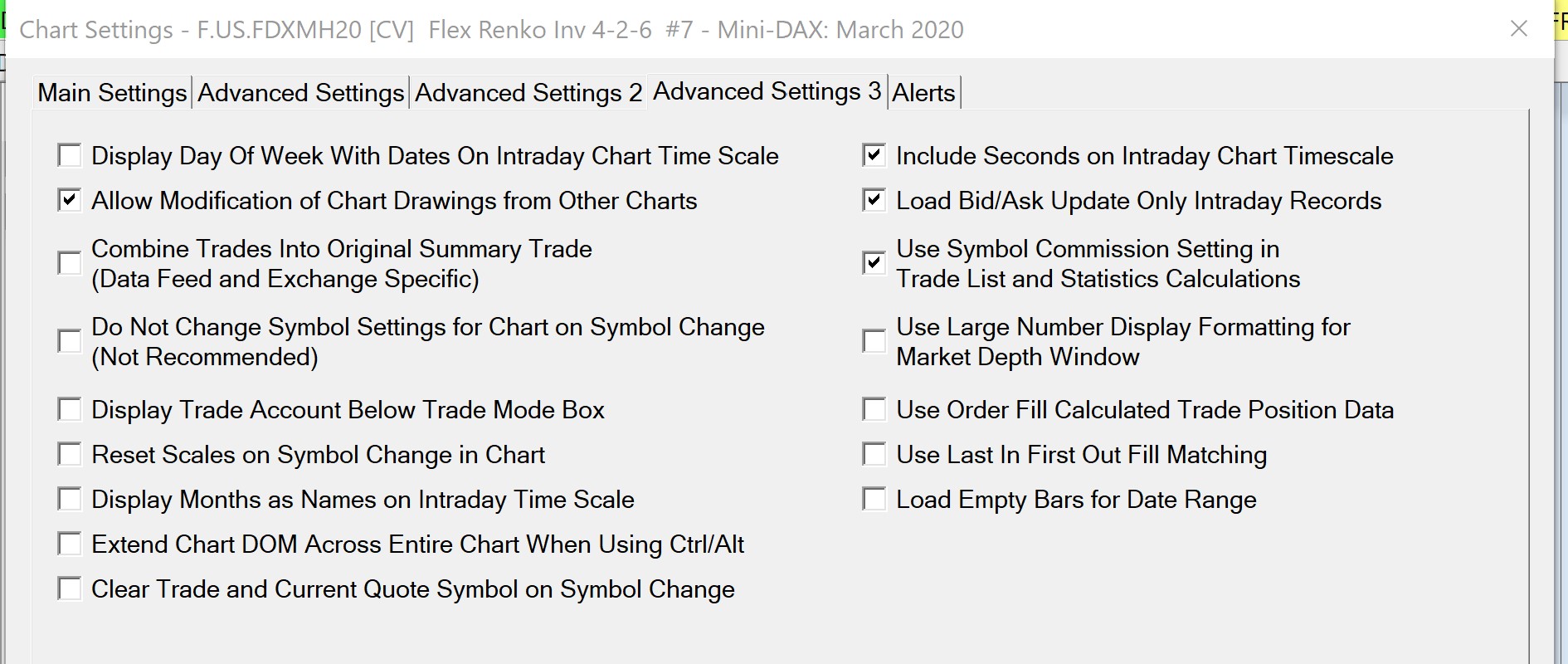

I have also updated the Chart Settings. Pic 3 attached

[2020-01-30 19:21:54]
Refer to the documentation here for this:
Trade Activity Log: Use Commission
You did not enable the option on the Global Symbol Settings window to use custom symbol settings values.
[2020-01-30 23:20:29]
User182987 - Posts: 3
Oh thanks. I completely missed the checkbox in the top of Symbol Settings.
All sorted now. Thanks
