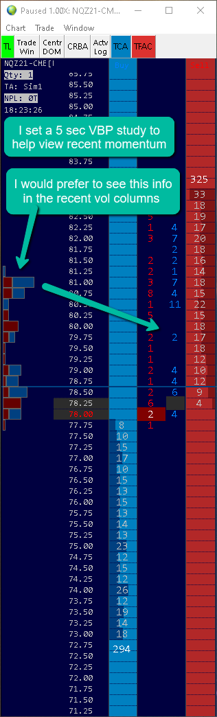

I was able to replicate the screen shots you posted. Made a few minor tweaks to the detection to try and resolve this. Can you please re-run the same tests and confirm the issue is resolved or if anything else crops up?
Thanks!
[2026-04-02 23:19:49]
Sébastien - Posts: 156
Updated to 2.0.6
I did the same test again.
Unfortunately it didn't fix the issue.
When the tail does a finished auction (diagonal print extremities), the calculation always take into consideration the stale volume.
And it created one more issue : now there are levels inside the tail that have no Histogram bar at all.
Some bars are invisible.
It happens very frequently.
