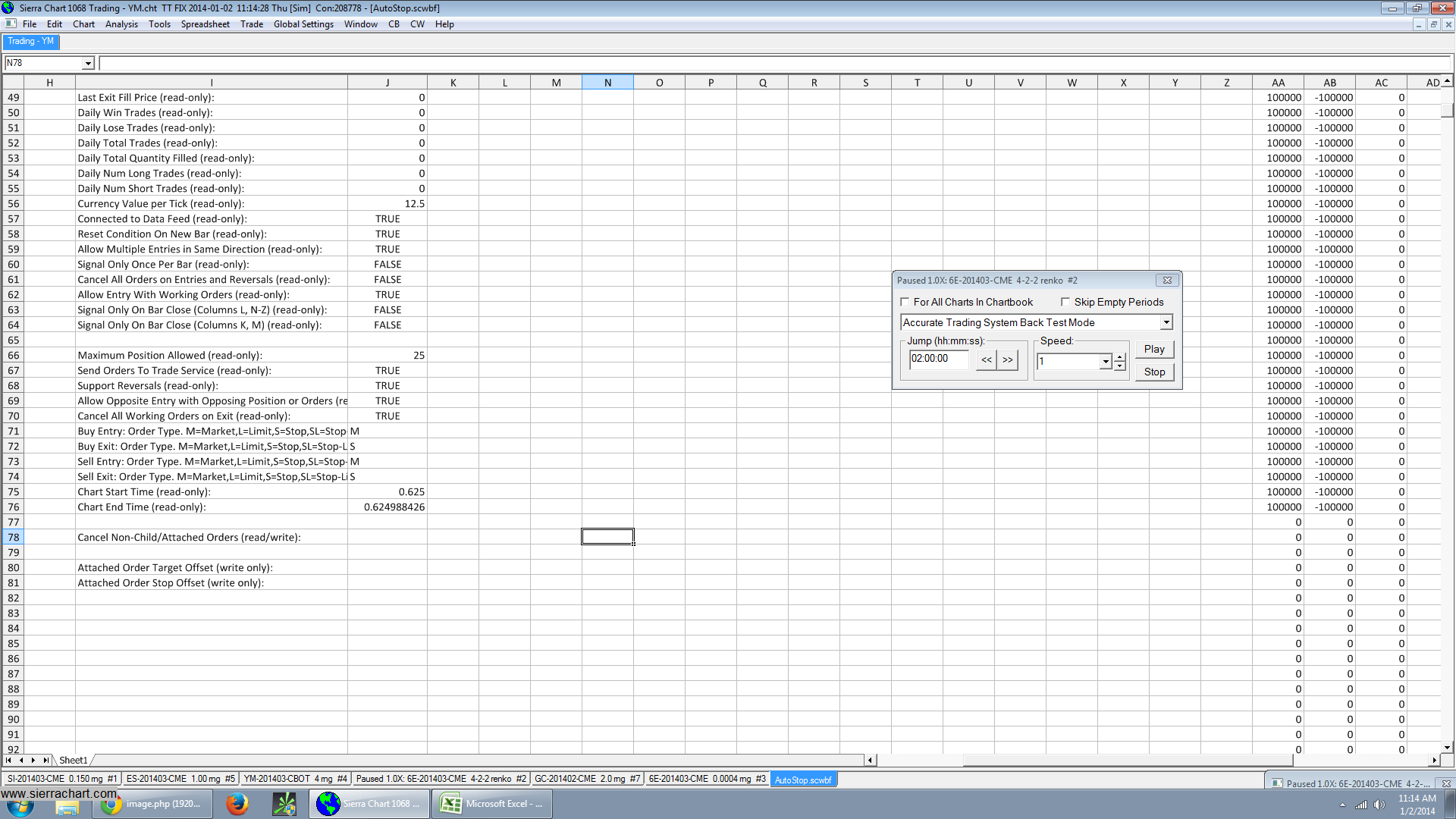

I've never done this before and I can't figure out what I am doing wrong either. I scale in and out of all my positions and I want to be able to place a safety stop 50 ticks off my average price in case my system goes down. I also want it to update in real time for the current quantity and flip based upon whether I am currently long or short. I prefer to use a spreadsheet so I can see where my order is and be able to manually override the price as necessary.
J23, Limit or Stop Price - Buy Exit (L) (read/write): =IF(J5<0, ROUND(J9-50*J21, 4), "")
J25, Limit or Stop Price - Sell Exit (N) (read/write): =IF(J5>0, ROUND(J9+50*J21,4), "")
J26, Order Quantity (read/write): =ABS(J5)
and then everything else is set as follows:
http://www.sierrachart.com/image.php?l=1388690071364.png
Thanks for any help.
[2014-01-02 21:09:31]
Sawtooth - Posts: 4360
I didn't pursue that issue because the client abandoned that approach in his system, and I never retested it later to resolve it.
Just in case you don't know this already:
-If you are not using Attached Orders for your stops and targets, it is so much easier to use them for a disaster stop.
-J22-J25 are prices only. They need a formula to go TRUE in K3-N3 to place the order.
-When the order is placed by the spreadsheet, J26 controls both the entry and exit quantity and it overrides the Trade Window quantity.
To alter the quantity of a pending order from the spreadsheet would require that you to cancel it with a formula in J29, and enter another. You could compare J3 and J5 to cancel it, then L3/N3 would need to go TRUE again.
If this doesn't cover it, what is it not doing?
[2014-01-03 05:08:23]
OK, I had a few minutes to try this.
You need to reverse the comparison operators in your J23 and J25 formulas.
Try this:
J23:
=IF(J5>0,ROUND(J9-50*J21,4),0)
J25:
=IF(J5<0,ROUND(J9+50*J21,4),0)
J26:
=ABS(J5)
J29:
=AND(ABS(J5)<>J3,J3>0)
L3:
=AND($J$5>0,$J$3=0)
N3:
=AND($J$5<0,$J$3=0)
[2014-01-03 18:21:49]
vegasfoster - Posts: 444
Hi, I caught that the prices were backwards, but the rest of it was all messed up. Because I am scaling I had to change $J$3=0 to $J$3<>$J$5, but now it works perfectly!!! You da man!!! Thanks a bunch.
