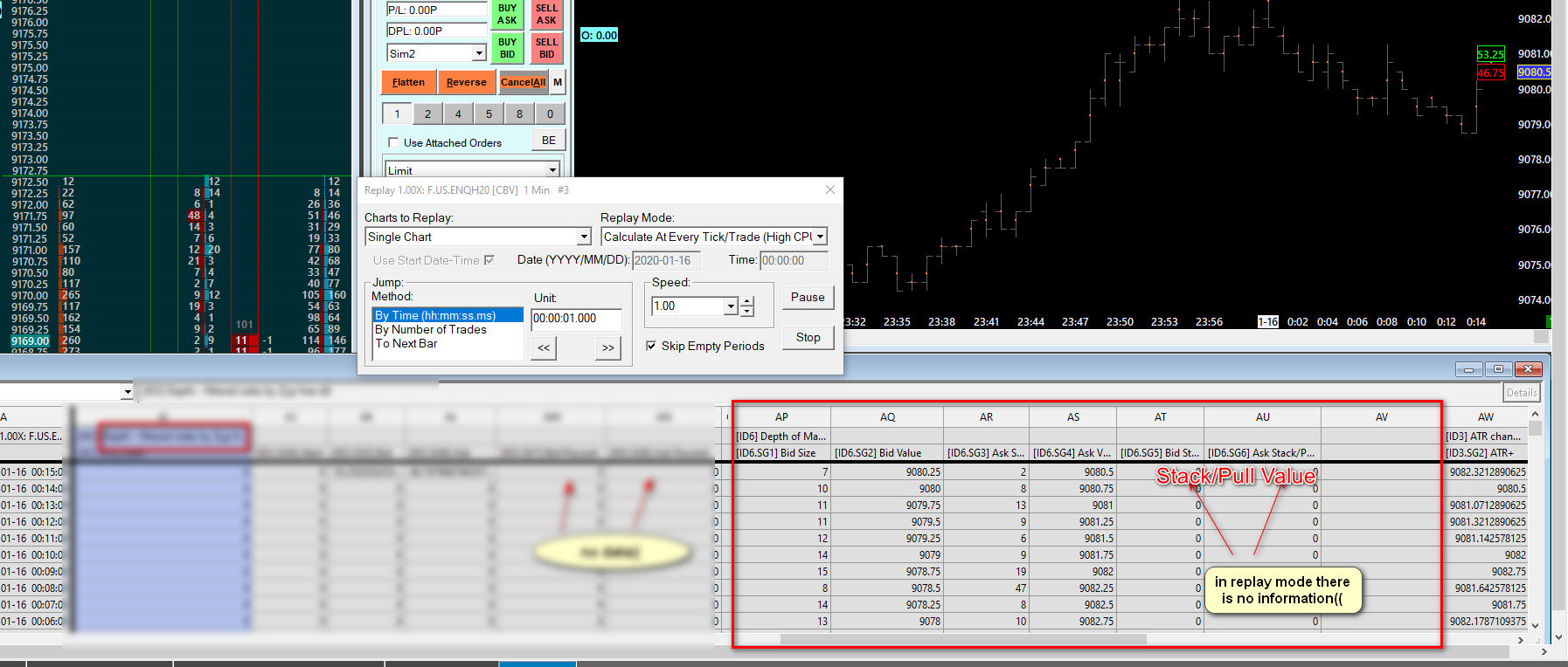

An excellent study of the Depth of Market Data, but I would like the Sierra Сhart programmers to make corrections in order to have the opportunity to work programmatically with data? In particular, the algorithm does not output data in a table in replay mode.
Record Date - Enabled in Settings
Date Time Of Last Edit: 2020-01-17 11:11:15

[2020-01-17 12:47:01]
Ackin - Posts: 1865
try:
You need to enable Trade >> Trading Chart DOM On. Also you need to have the pulling and stacking column added to the Chart DOM. Otherwise, the data is not being maintained.
Date Time Of Last Edit: 2020-01-17 12:52:24
[2020-01-20 05:28:44]
Make sure you can see the pulling and stacking market depth data on the chart and have added those columns:
Trade Menu: Show Market Data Columns (Trade menu)
