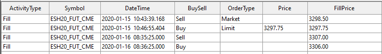

On todays fills I'm missing the order type (Market, Limit,...). Is this something I misconfigured?
Yesterday everything was fine and I didn't make any update to a new version
Screenshot attached.

[2020-01-16 17:50:21]
How did you enter those orders? Through Sierra Chart?
[2020-01-16 19:20:56]
nosast - Posts: 324
Yes. Right in the DOM. It was either LMT or MIT. I found this issue while wanting to clarify that.
The trade was made on another machine and I'm seeing no order type on the current machine. Need to doublecheck in the office tomorrow but I thougth this gets syned with all order details.

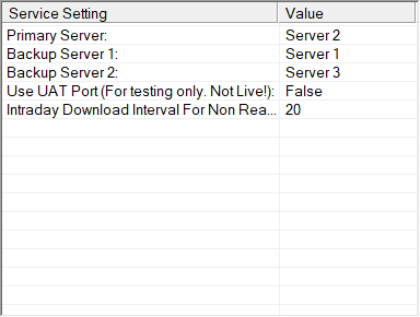

[2020-01-16 23:05:24]
What are the Backup servers set to in that installation of Sierra Chart where the order type was missing?
[2020-01-16 23:21:18]
nosast - Posts: 324
attached

[2020-01-17 09:15:25]
Actually it is clear to us now why you do not see the Order Type because those are inserted fills received upon connection.
