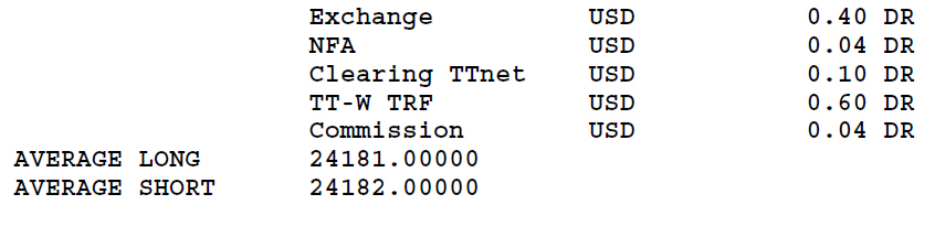

[2020-12-18 21:34:13]
User287830 - Posts: 9
This is still an issue.
Do you have a preferred broker? as this is ridiculous on AMP's part.
See attached from my statement dated 12/17/20
imageAMP.PNG / V - Attached On 2020-12-18 21:32:48 UTC - Size: 4.22 KB - 639 views

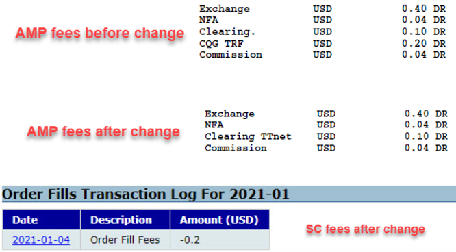

tobi - Posts: 351
I can confirm, that after changing from AMP CQG to SC TT order routing the total fees are still the same.
Attached are the fees for a 1 contract Micro-NQ trade.
imagefees.png / V - Attached On 2021-01-05 08:41:10 UTC - Size: 124.48 KB - 635 views
[2021-01-05 09:45:01]
Good.
