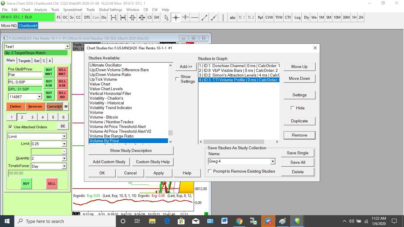

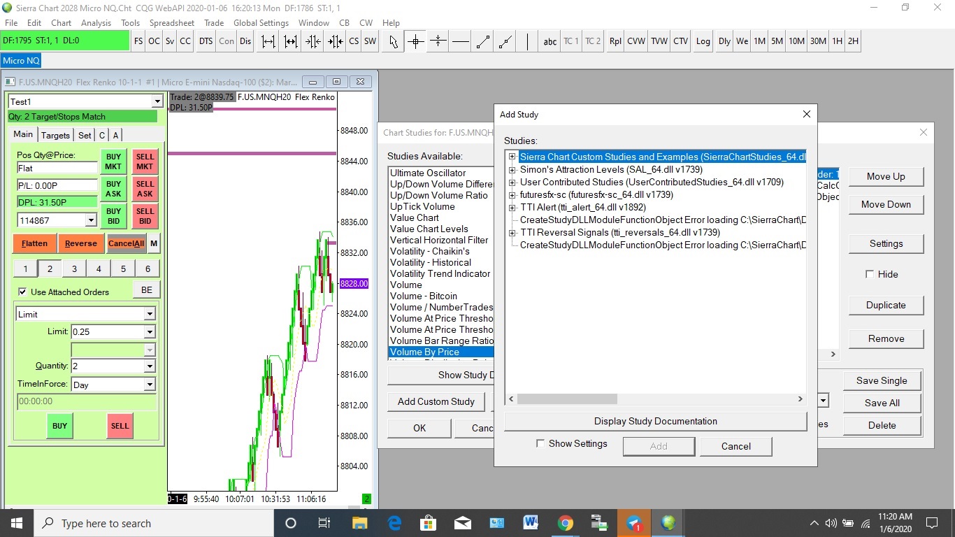

I have a volume profile study from Simon at The traders institute, Simon,that I paid for. It shows up in 32 bit but not in 64 bit. They checked and made sure my permissions were ok. They said they unlocked my account but because there is no way to differentiate 32 and 64 they do not know why this is happening. Other people are not having this issue. When I open custom studies there it is in 32 but then in 64 the study is not there. Can you help. Greg

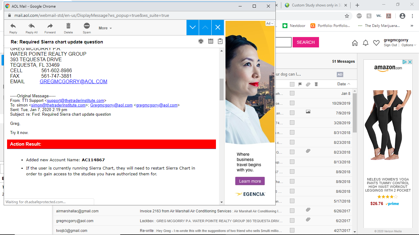

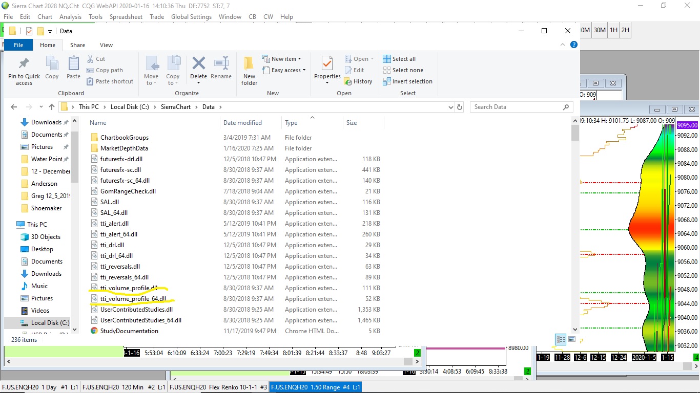

The drl is there but I do not see it in 64 bit. can it be corrupt or something? I attached a pivture of my data file and a message they sent me from sierra. I did restart and that did not work. Thanks, greg
imageDLL.jpg / V - Attached On 2020-01-16 14:19:03 UTC - Size: 300.87 KB - 405 views
imageSierra info.png / V - Attached On 2020-01-16 14:19:14 UTC - Size: 273.31 KB - 362 views
[2020-01-16 14:34:26]
ForgivingComputers.com - Posts: 1239
I see you have the files. You can try removing the studies from the chart and then re-adding them. The only other thing I can think of is to close Sierra and remove them from the folders (or delete them) and see if they get downloaded from the Sierra server and then see if they show up or can be removed/added.
