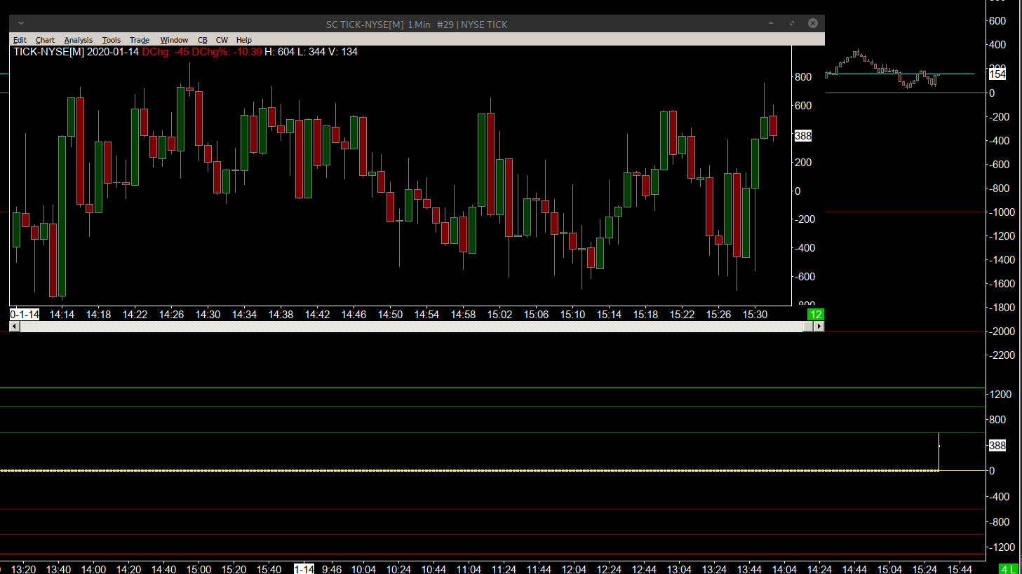

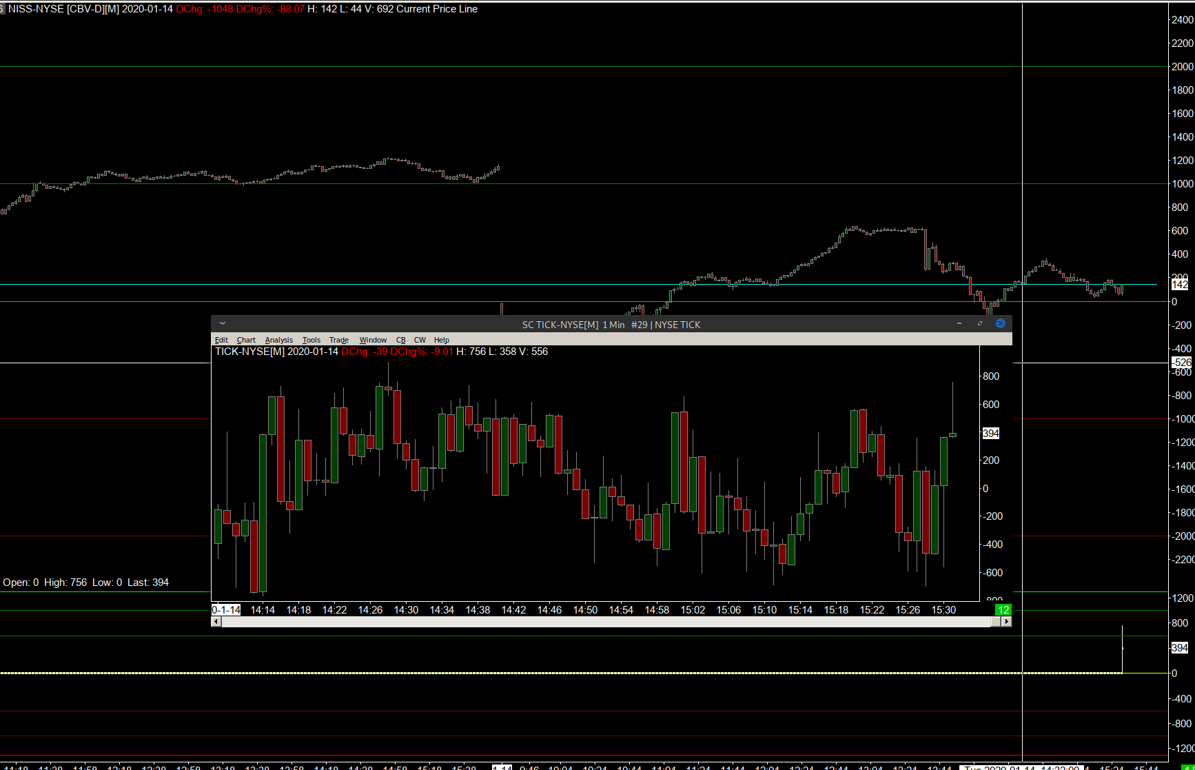

there is definitely an issue here..
after a restart all the data is gone again, from the additional symbols...
however, when i fire up a dedicated chart with that symbol it plots just fine, pressing Insert to reload the chart with the additional symbol results in a "reset" of that additional symbol..
see:
imageib_sc_additional_symbols_issue_1.png / V - Attached On 2020-01-14 20:34:24 UTC - Size: 74.13 KB - 444 views
imageib_sc_additional_symbols_issue_2.png / V - Attached On 2020-01-14 20:34:29 UTC - Size: 48.61 KB - 313 views
[2020-01-15 01:16:58]
Yes we do see a problem. We are looking into this.
[2020-01-16 01:13:21]
The problem is identified and resolved and we will have a new release out later today. It related to an optimization for looking up studies being referenced by alert conditions and by other studies.
