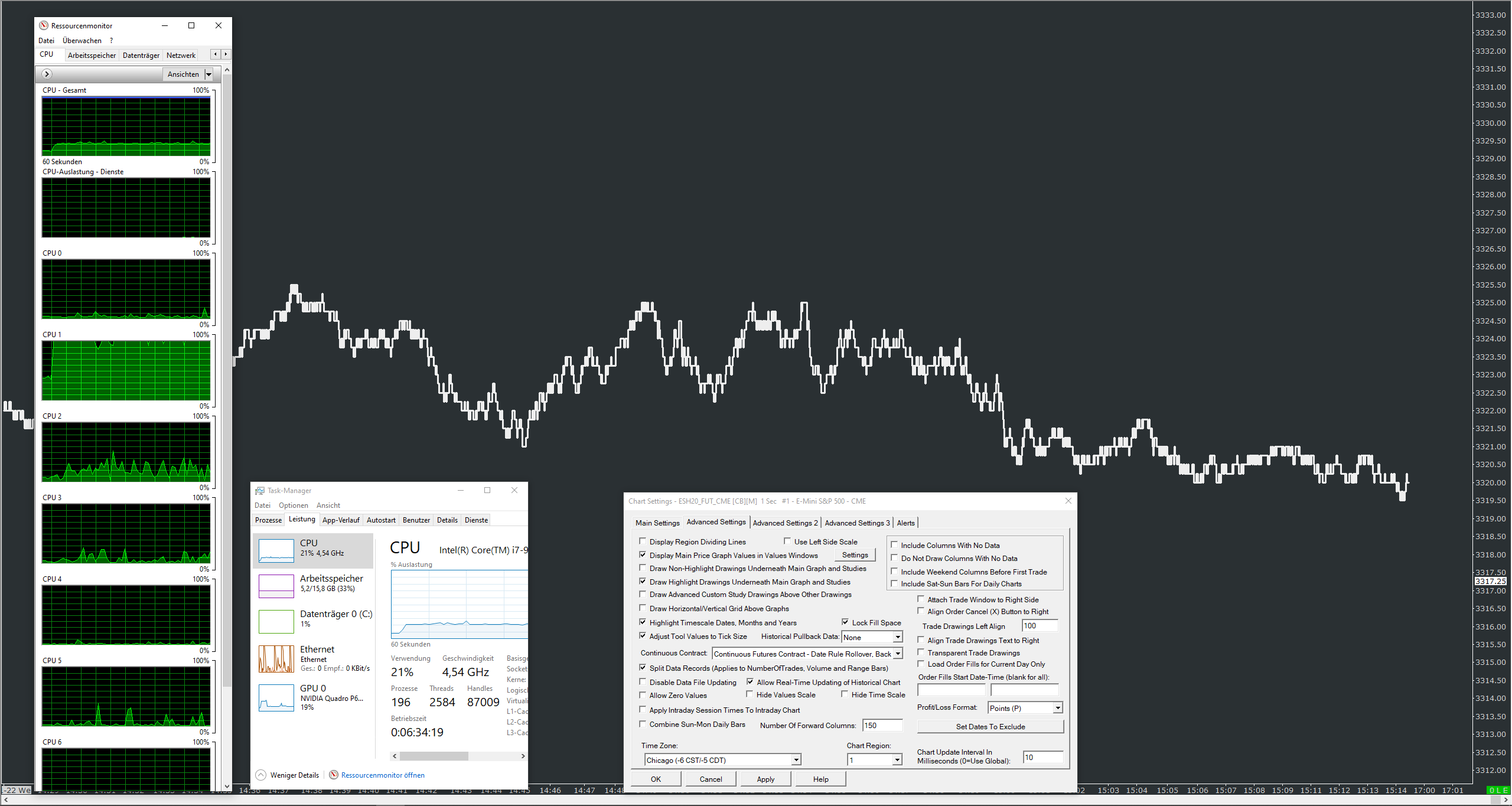

I got one chartbook open (fullscreen) with a 1s chart of ES and 10 ms update interval. One core is maxed out which I absolutely don't like. Also the ES is currently closed so the stress is only caused by the graphical update of the chart which is insane.
Chart drawing time is around 25ms to 30ms also unbelievable high for a blank chart.
PC is up to date i7 9700, 16 GB, SSD,...
Could this be caused by Win10 alone? I had Win 7 before on older hardware and as far as I remember this was running way smoother.
Any advice appreciated before going to install the system with an outdated Win 7.

[2020-01-22 22:30:05]
nosast - Posts: 327
I don't or better said I can't use 10 ms update interval. Typically it is around 250 ms but for the feed test from elj00 I needed to set it that low.
But a market depth full screen window (set up similar to bookmap) will also cause nearly 70-90 % usage of one core with only 250 ms update interval.

JM-JO - Posts: 38
I guess the issue here is the slow graphic calculations of Sierra with Windows 10. Your CPU is a very good one.
Ideally you should compare (benchmark old vs new PC) several study calculations and Chart drawing time with no connection to market feed, under exact same conditions (same day, same window, same studies). I guess the study recalculations with the new PC should be faster but not the Chart Drawing Times. And long Chart Drawing Times is what makes Sierra sluggish.
By the way, did you change the monitors resolution with the new PC? This has dramatic effect as well on Sierra. Twice more pixels means twice longer chart drawing times for Sierra.
A Windows 7 licence key is 3$ on ebay ;)
Date Time Of Last Edit: 2020-01-22 23:02:47
