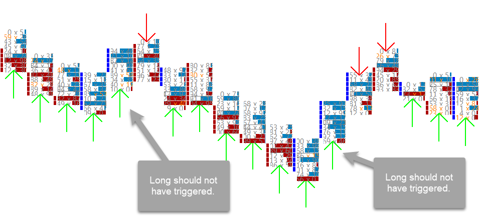

tommartin321 - Posts: 81
Thanks tomglib.
The shorts seems to be working fine using the following:
=C3>MAX(C4:C7)
However, I can't seem to understand why the longs are generating signals when the criteria is not being met (see attached file). Longs should just be the opposite. The low of current bar should be < the low of the previous 5 bars. But you can tell from the attached picture, it's generating long signals when the previous bar has a lower low.
=D3<MAX(D4:D7)
Thanks,
Tom
imageLongs not working.png / V - Attached On 2020-01-02 01:58:37 UTC - Size: 68.1 KB - 397 views
[2020-01-02 02:42:11]
Sawtooth - Posts: 4355
Try this:
=D3<MIN(D4:D7)
[2020-01-02 08:14:52]
Thank you tomgilb
Using MIN did the trick for the buy side.
