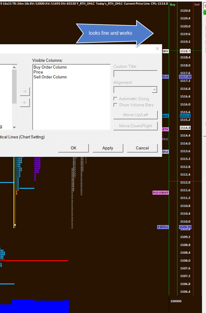

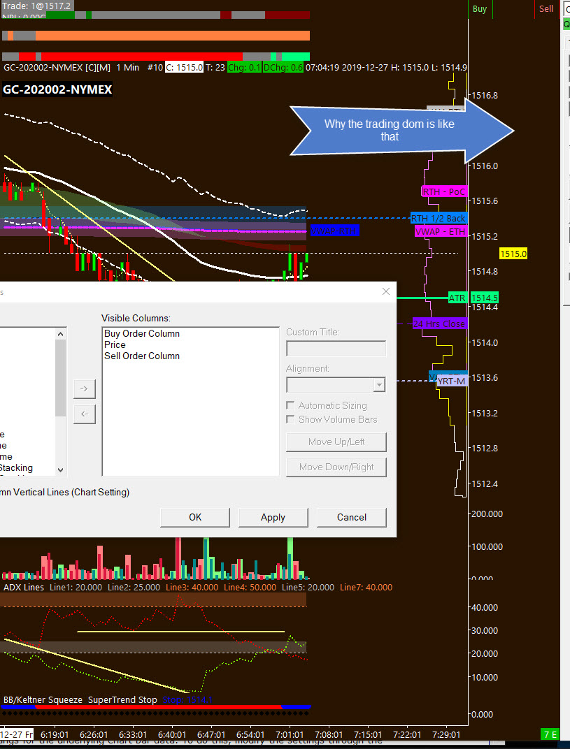

I am having an issue with the trading chart Dom. it is not displayed right in multiple charts (see image issue). On another chart, in the same chart book, it looks and works fine (see image)
imagetrading doom issue.jpg / V - Attached On 2019-12-27 12:11:34 UTC - Size: 257.17 KB - 437 views
imagetrading doom working.jpg / V - Attached On 2019-12-27 12:11:41 UTC - Size: 136.98 KB - 458 views

Here it is, I think it might be because I have the main price chart on the bottom region, Can this be dealt with?
attachmentDom Issue Chartbook.Cht - Attached On 2019-12-27 14:49:20 UTC - Size: 58.89 KB - 459 views

With regards to the Trading DOM, the issue is that you have the Main Price Chart not in the first region. The Chart DOM is only drawn in the first region. This is not something that will change anytime soon.
