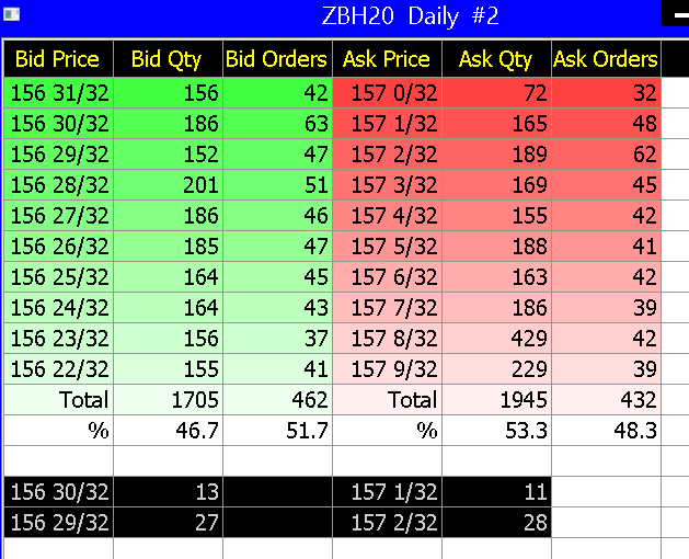

Not a 500% increase in most cases. Here is the current example:
http://www.sierrachart.com/image.php?Image=1575660674221.png
The numbers at the bottom in black is the implied depth. The numbers at the top are the unadjusted standard depth quantities.

[2019-12-18 04:12:32]
Sierra_Chart Engineering - Posts: 25330
In response to post #3, we understand what you are saying. Could you please post your comments here about this:
bids offers closes to price on market depth historical graph
It is hard for us to make this an option. Either we just have to take it out which is no problem or we just have to leave it.
However, can you tell us what symbol you are referring to and at what time and time zone. This is what we currently see for ZBH20 (refer to attachment).
The top is the standard order book and the bottom is the implied depth. The implied depth adds very little at this time. Below 20%. And certainly not 500%.
Update: We see that you are mentioning ultra bonds (UB). Yes we do see what you mean in that case. Our example is with ZB which is different. However, we are not seeing up 500% difference. More like 200% at one level.
Date Time Of Last Edit: 2019-12-18 04:17:36
