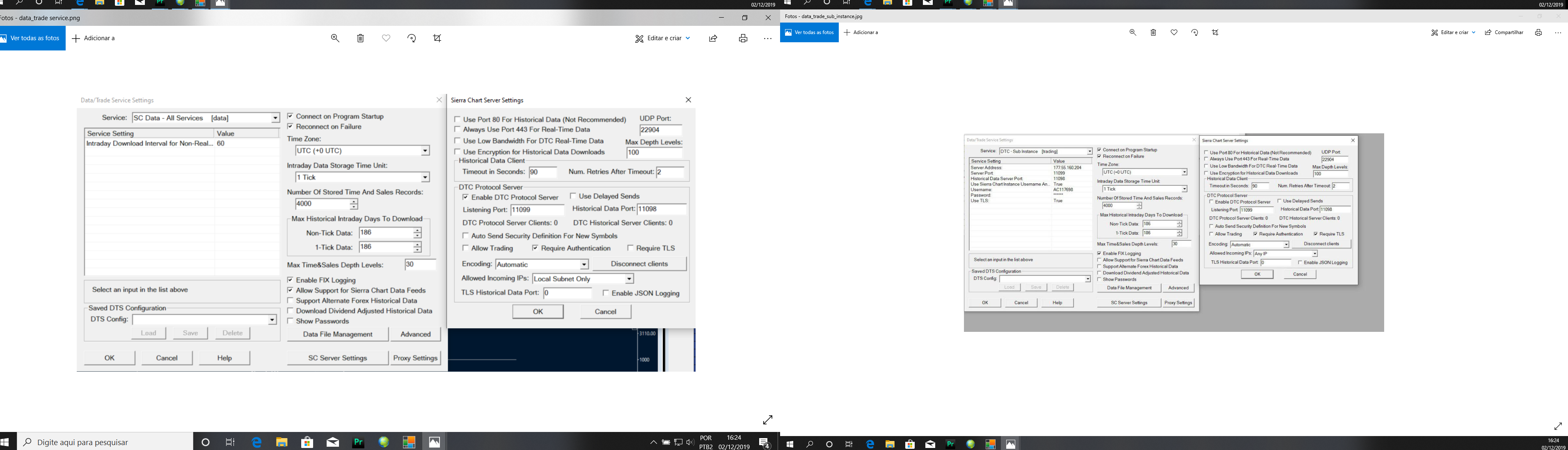

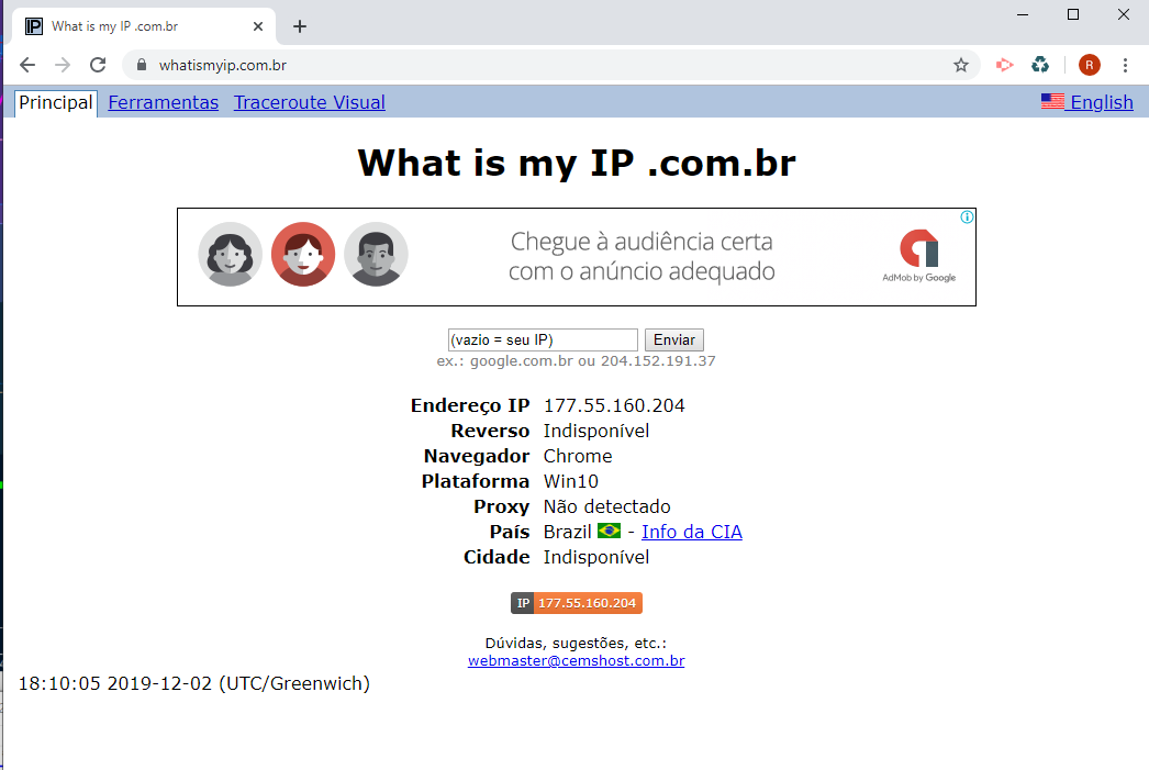

Hello, i'm trying to make the sub instance work in a different computer, but i'm doing something wrong.
i had attached 3 pictures. 1 is the server IP. The second is the server configurations. The third is the configuration i had set in the sub instance.
Thank you.

On the instance of Sierra Chart used as a server you need to enable the Require TLS option. And you also need to set the Allowed Incoming IPs to Any IP assuming the computers are on different subnets.
You also have to make sure there is clear communication available between the instances of Sierra Chart using the particular port that you want.

I made the changes you told me to. When i try to connect i get this message on the sub instance:
Davi Laatus, [03.12.19 14:33]
DTC - Sub Instance | Connecting to the server 177.55.160.204. Port 11099 | 2019-12-03 17:31:38.904
DTC Client socket (1) | Creating socket. Using TLS 1.2. | 2019-12-03 17:31:38.904
DTC Client socket (1) | Connecting to IP: 177.55.160.204. | 2019-12-03 17:31:38.905
DTC Client socket (1) | Connect event error. Windows error code 10060: Uma tentativa de conexão falhou porque o componente conectado não respondeu
corretamente após um período de tempo ou a conexão estabelecida falhou
porque o host conectado não respondeu. | 2019-12-03 17:31:59.907 *
DTC Client socket (1) | CloseSocket call. | 2019-12-03 17:31:59.907
DTC Client socket (1) | Closed. | 2019-12-03 17:31:59.907
Error connecting to Data or Trading service. For help with this issue, press the 'Send For Analysis' button on this window. | 2019-12-03 17:31:59.907
Select 'File >> Disconnect' to prevent further connection attempts. | 2019-12-03 17:31:59.907
DTC Client socket (0) | CloseSocket call. | 2019-12-03 17:31:59.924
DTC - Sub Instance | Disconnected. | 2019-12-03 17:31:59.924
Will reconnect to the server in 3.0 seconds. Select 'File >> Disconnect' to prevent further connection attempts. | 2019-12-03 17:31:59.924
Maybe its some port problem? If thats the case theres any instructions that i can take a look?
Thank you.
[2019-12-03 18:29:12]
You are going to need to resolve this problem:
This is not within the scope of our support.
